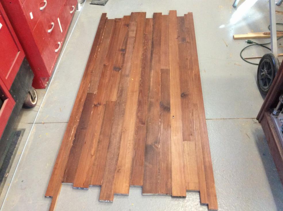

    Like this?

      Yes! That will work. Never thought of that. Thanks.
    • 3752
    My favorite way of gluing up table tops is with 3-4" wide boards. Wide boards like your 18"'are prone to cup and turn your table into a feeding trough!

      Do you mean 18 inch long pieces patched together to make 57" long or do you mean 18" wide boards?
      I think you mean like Capncarl's photo, that should work. with modestly wide board pieces.
      • bmuir1616
        bmuir1616 commented
        The boards are 6 inches wide and can be ripped to any width. I want to glue 18" long boards into a total length of 57". Con you do it this way?
