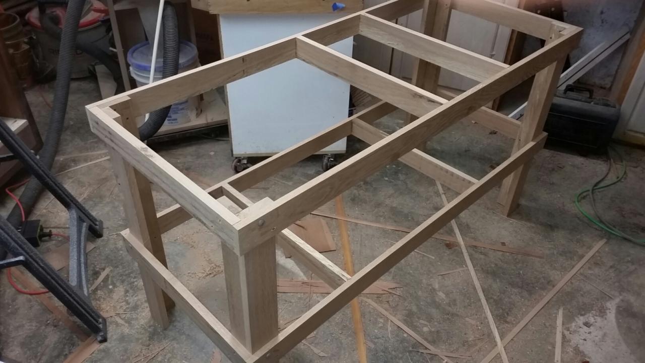

    I've been wanting to build a table for my BGE for over a year. My BGE sits in a nest, but it's always inconvenient to find a spot for the stuff I'm grilling or for grilling accessories.
    I didn't want to buy more wood for this. I've had some white oak boards I bought freshly cut over 8 years ago and have been waiting for a project. I also have a bunch of ipe deck boards I bought from the Habitat Restore.
    The table frame and bottom shelf will be white oak and the top will be ipe.
    The two boards that make each leg are joined at a right angle and held together with 3 dominoes for alignment and Titebond 2 glue.
    The stretchers and aprons for each shelf are held together with dominoes. I really like the Domino. I did mess up on the Domino placement on the top aprons. I'm going to fill them with half dominoes.
    I attached the shelf frame to the legs with 4 1/4" carriage bolts at each corner. After all this time, I figure the wood is free. The nuts, bolts, and washers are the most expensive things on here. I drilled 1/4" holes for the bolts and then chased it with a 9/32" bit 1/4" deep to accept the square base underneath the lag bolt head.

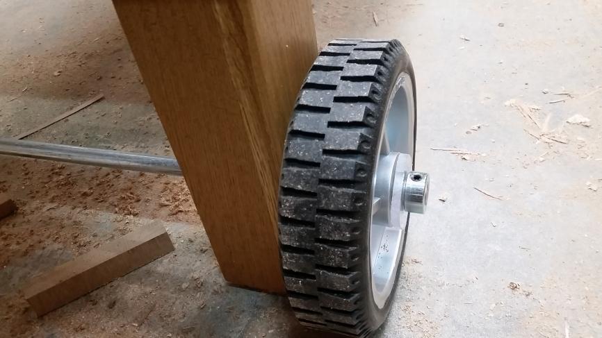

    Looking good. Are you going to put it on wheels?
      Yes, I'm going to drill 5/8" holes in the legs on the Egg end of the table, run a metal rod through, and slide on 2 wheels. It will get moved around like a wheelbarrow.

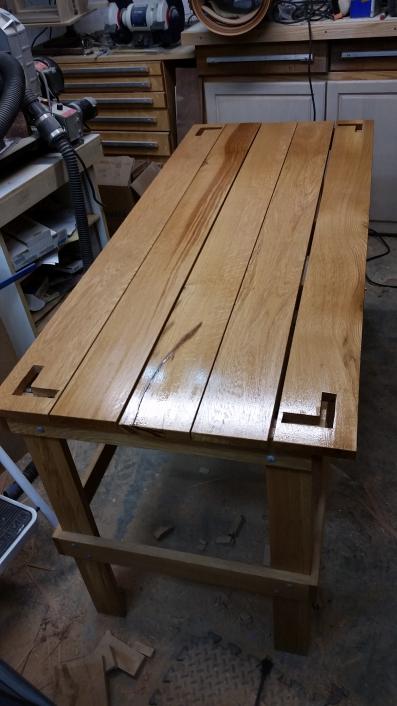

                      The whole table frame is finished with spar urethane and the bolts installed. However, as I was laying out the boards for the lower shelf, I didn't want to notch the boards around the legs and leave a chunk of wood missing at the outside corner. Instead, I decided to slip the board over the legs as you can see in this pic. They're glossy because I just wiped on some finish. From this distance the cutouts look OK. Get closer and it's embarrassing. I need practice with my jigsaw.

                      I also drilled for the axle and mounted the wheels. I didn't want the wheels rubbing against the frame and I didn't want to run out and buy big washers so I used some scrap polycarbonate as a spacer. The screw collar also slips into the wheel's hub--which I didn't want--so I also made an outside hub with the polycarbonate.

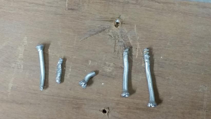

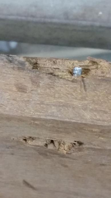

                      So today I turned my attention to the ipe top. Since these were salvaged deck boards, there were some snapped off stainless screws I had to deal with. Fortunately, of the 4 boards I've got, only 1 has screws still in it. However, they were all screwed in at an angle at the edge of the boards, the square drive heads were stripped, and the broken piece of screw on the underside of the board had been hammered flat to the board--I'm guessing making it safer to transport.
                      I managed to pound out or twist out most of the screws. There's still one more buried in there.

                      But I've got at least 1 more stubborn one on the edge to deal with. I need to pound it out a little more so the vice grips can get a little more purchase. I want to clean up the edges so I can get one clean rip on my TS. I don't want to hit one with my blade. Unfortunately, my HF metal detector isn't picking up the stainless screws. I'm going to make ipe plugs and then plug what holes I can.

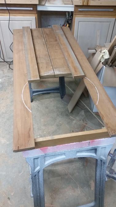

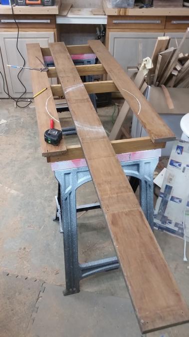

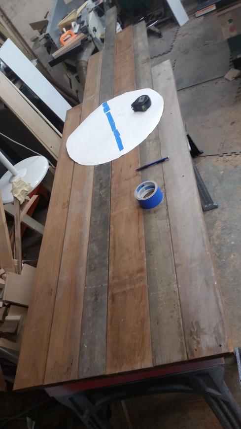

                        I think when most of us need to cut a hole in a top we've made, we lay out the boards covering the whole top, draw the circle to cut out, and then cut it out. I have a 21" diameter hole to cut out so that's almost 2.5 sqft of wood that will essentially be wasted. Not only that, but if you look at the picture below, I'd be left with a bunch of random length offcuts without really a purpose. My boards were also fairly random width and I didn't like that there wasn't symmetry in the boards.
                        Click image for larger version  Name:	20161014_160405.jpg Views:	1 Size:	47.9 KB ID:	827819
                        I'm always looking to save where I can and it's not like I'm getting any more ipe any time soon. A lightbulb went off as I was drawing the circle on the boards with my compass. If I precut the boards where the circle overlapped the boards, I'd have enough leftover to re-use it. After some measuring, some more measuring, and even more measuring, I was ready to cut.

                        With all the pieces cut now, I was able to save 2 whole boards at their full length for another project.
                        Click image for larger version  Name:	20161014_164738.jpg Views:	1 Size:	36.1 KB ID:	827821
                        Now I've got to make some ipe plugs to plug the screw holes.

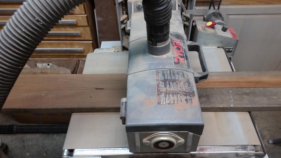

                          Haven't had much free time to work on this cart but I managed to squeeze some time in today.
                          After I laid out the top boards, I ran them through my drum sander. The boards cleaned up very nicely.

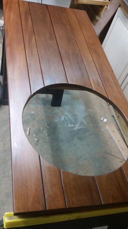

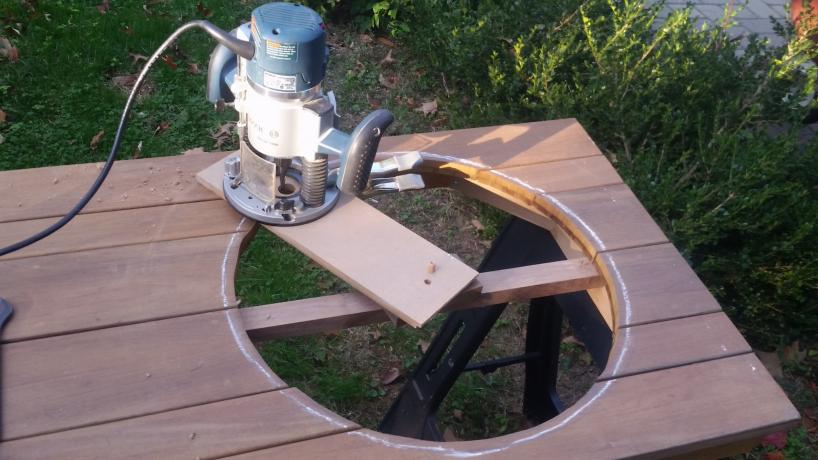

                          I cut out the hole with my jisaw then rigged up a router with a spiral carbide bit to cut out a clean hole...at least that was the idea.
                          I lowered the bit ~1/8" at a time. The first pass was fine. Then on my second pass, I'm fuzzy on the timing, but my wife exited the house to walk the dogs and the router went for a ride. The bit caught and yanked the router out of my hands. By the time I caught the router again--it's amazing how many thoughts went through my head in that split second like "oh, crap", "I hope it doesn't land on me", "where's the power switch", "oh, man, you were running in the wrong direction--it had traveled almost 360deg. As I mentioned, I got confused on which way to run the router and I was climb cutting for those 2 passes. It torqued my left wrist and tore out some wood which had me POed.
                          Anyway, I think I sanded away most of the problem areas and now I'm on to finishing. The ipe looks brand new after one coat of spar urethane.
