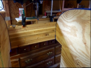

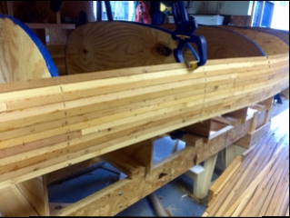

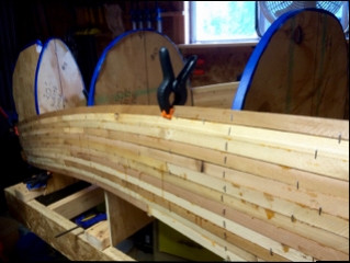

              Some progress the last couple of weekends.
              g.
ID:	827408 Click image for larger version
ID:	827409 Click image for larger version

                  Wow! are those strips (looks like) stapled on? or are they glued on and glued to each other? What kind of glue?
                  • gsmittle
                    • 2792
                    • St. Louis, MO, USA.
                    The strips are stapled to the forms, with some staples in between to keep the strips aligned. The strips are glued edge-to-edge to each other. The glue is Titebond II.
                    Once the shell is complete, I'll pull the staples, sand the whole thing, then cover it in fiberglass cloth and epoxy. Then do the same to the inside. Then add gunwales, thwarts, seats, make paddles, etc. I'm hoping to get it in the water next spring.
