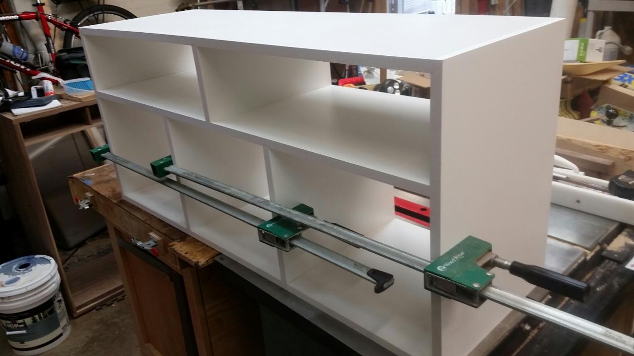

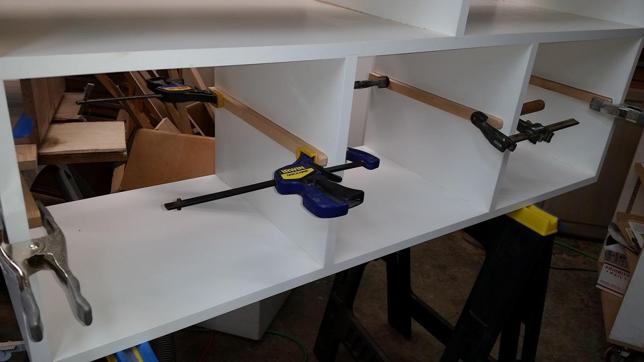

          Well, that was an interesting glue-up!
          I had some time to kill before going into work this morning so I decided to rabbet for the back panel and cut the internal dividers shorter to accept the back. Done.
          This evening while the family was in the inflatable pool, I decided to do the glue-up. I put glue in the bottom two grooves and then slid in the first vertical divider.
          What the?!!! I cut my rabbet the opposite of what I needed--too wide and too shallow. So now I need to rip off the thickness of my back panel from all the boards and cut the rabbet deeper so the back panel has more purchase.
          If that wasn't bad enough, just before I start up the TS, I realize my blade is backwards. OK, fix that. Rip all the boards down. Install the dado stack, deepen the rabbet.
          I'm re-assembling all my pieces and then I realize I forgot to rip down one of my side panels! So now I have to reinstall the melamine blade, remeasure for the cut, then switch over to the dado stack.
          And all this while I still have glue in those two grooves.
          I'm doing the first clamp up and my wife says they're done and the kids need a bath! Argh.
          So everything is in clamps now but during all that commotion, something went down the wrong pipe and now I've got hiccups!

              Yep. HD had a nice 1/4" panel that is already finished white on one side and already 2x4 which is essentially the size of this box. All glued surfaces are particle board to particle board, nothing to melamine except a small bit of shoulder.
              The box seemed pretty solid this morning after I took off the clamps and I'm going to go through tonight and reinforce with screws.

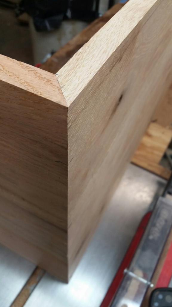

                  This morning I glued up the top and side panels before church, and after lunch, used my Dewalt track saw to cut a 45deg bevel so the corners meet in a miter. First time and not a lot of extra wood for practice. No pressure. The Dewalt bevel gauge is kind of fat so I eyeballed where I should lock the bevel knob. The Dewalt also tips over at 45 so it's a little awkward making the cut--you need your left hand to press down on the base while you plunge and push with your right. The Dewalt also cuts just a little bit away from the rubber guide strip during a bevel cut so I had to sneak up on the final cut.
                  After making the 4 bevel cuts (2 on the top and 1 for each side), I cut 4 Domino slots at each miter--also my first time cutting Dominos at an angle. I was pleasantly surprised that everything came together well over the 16" width.

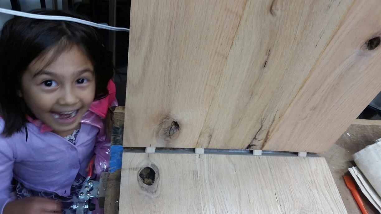

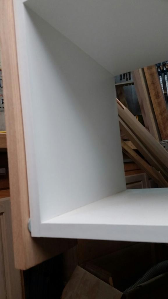

                  I was really worried I'd cut the top too short but I ended up doing the exact opposite and left it about 1/8" too long. I had already cut the Domino slots so I couldn't recut the miter. So I decided to make it into a feature. I'm going to use washers on the sides and top to create a small shadow line and I'm also going to project out the leading edge of the board 1/2" from the main cabinet. This way if there sides aren't perfectly parallel to the cabinet, it will be pretty much impossible to tell unless you use a ruler to check. The sides have been cut down to match the length of the cabinet.

                  I mixed up some epoxy with black and reddish powdered wood dyes and filled in the cracks and small knot holes. The shop was hot and I had to work fast.

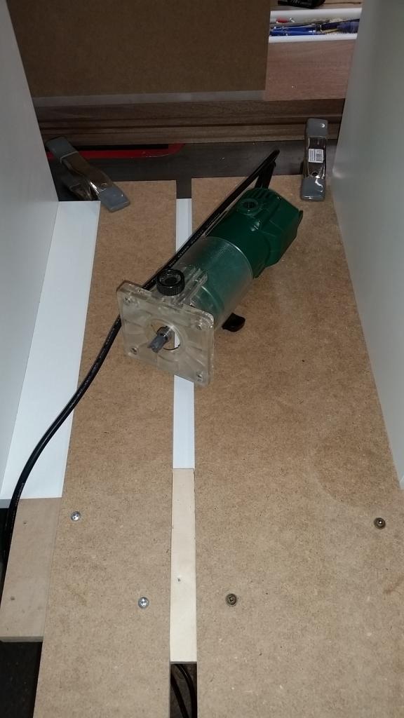

                    I decided to make a dado for the runner and for that I needed a jig. I was going to use a dado cleanout bit. It has a short section of carbide with a bearing on top. This way I could just make my jig around my runner and not do any math for the base offset, etc. Simply enough, right?

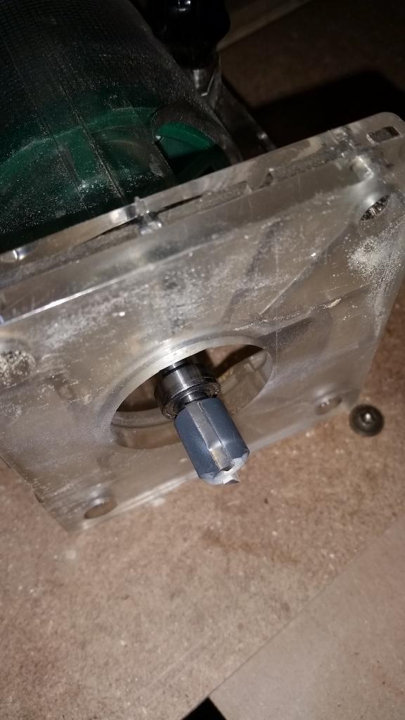

                    That is until I started routing the dado and realized the bearing had slid up the shaft and now the shaft was acting as the bearing and the cutters were undercutting the jig and making my dado too wide! I don't remember the last time I used this bit but when I went back to the drawer, I found the little stop collar that's supposed to sit on top of the bearing. Once installed, it worked as it should.

                    With the dados cut, I glued the runners into the dado.

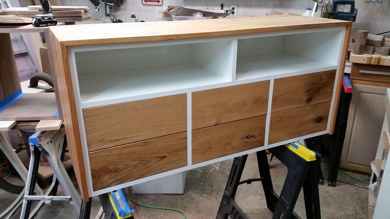

                        Got a few coats of rattle can lacquer on the drawer fronts and right now they are double stick tape and pin nailed to the boxes. I need to buy some shorter screws to attach them. I also need pulls. My wife wants knobs but I want more modern pulls that attach to the top of the drawer and are more sleek/modern. The wrap is secured to the cabinet, too.
                        I took the day off tomorrow. I'm going to work on the base (I'm thinking red oak and then spray painted black) and cut the slots for the wires.
