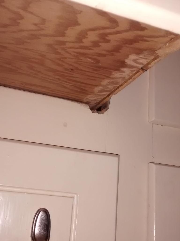

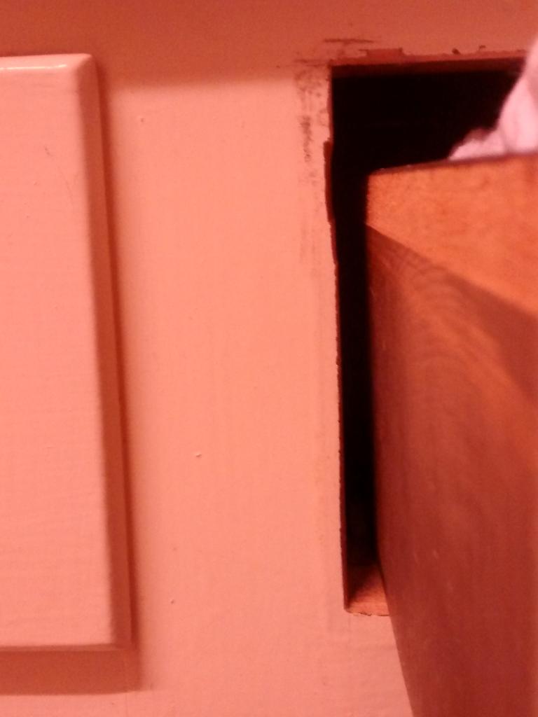

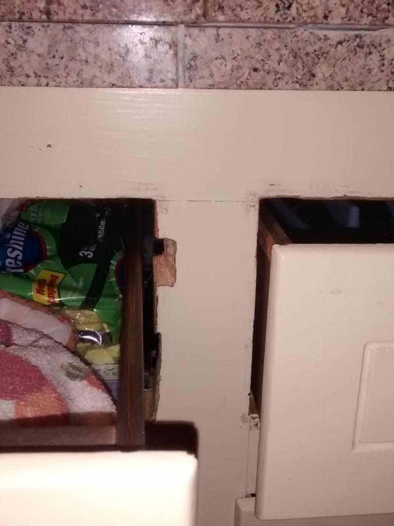

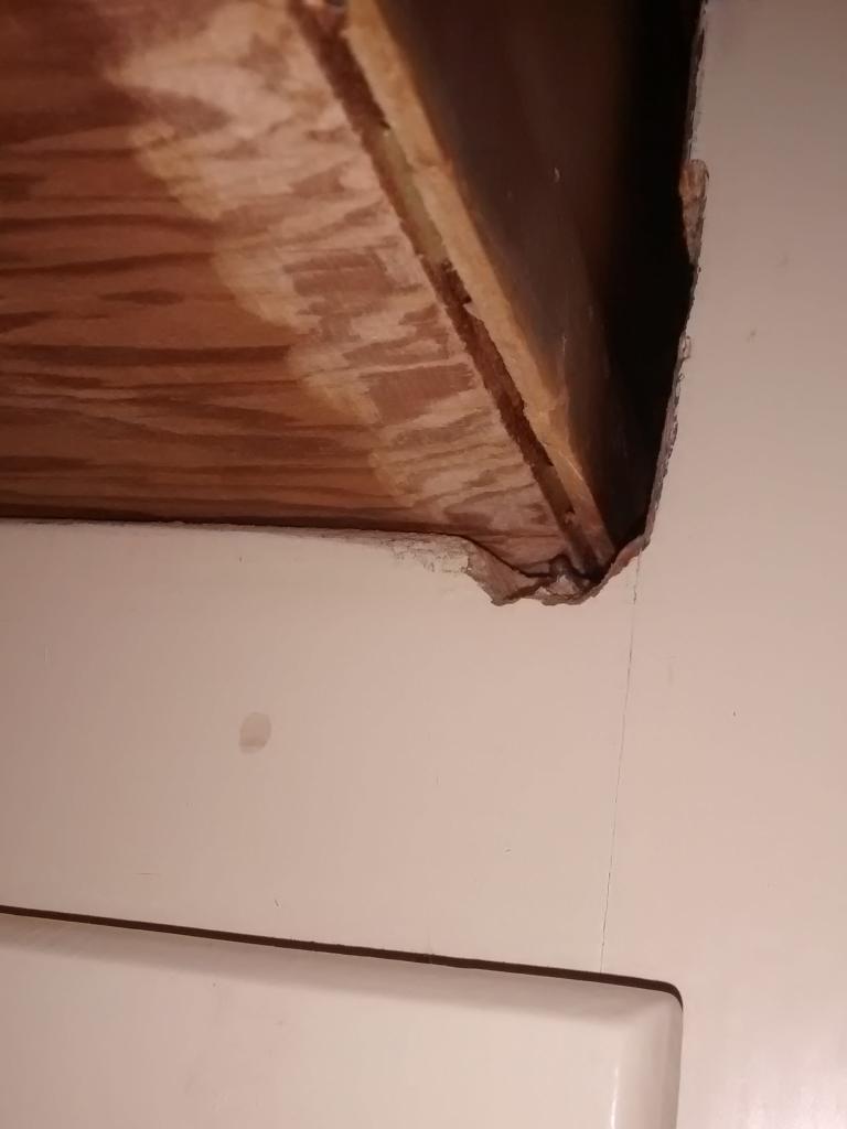

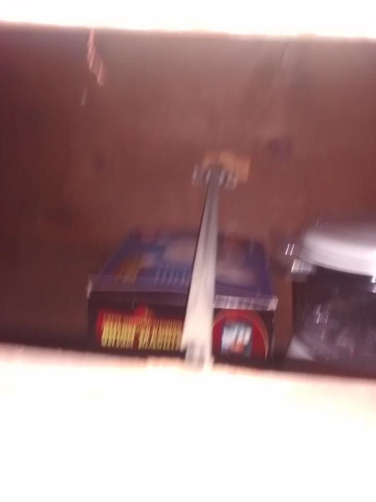

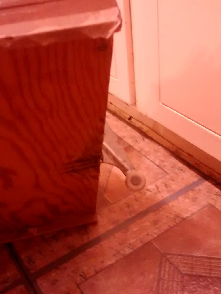

              Thanks everyone. Here are images.
              http://postimg.org/gallery/2qw0yniiy/
              A few here. Hideous.

                It looks like someone has already tried to install different slides. You may be able to fit the 1/2" slides in some of the "enlarged" openings. To answer you question of how to install something to attach the new slides to.... I would cut a 1x4 that would just barely fit beside the drawer in the cabinet and attach it to the back of the cabinet and the face frame using a Kregg pocket hole jig. You could test the fit of the new slide by cutting a piece of wood the same size as the new slide and using it as a mock up.

                    Viewing the photos showing the damage to the face frames you may be able to build new face frames with wide enough openings to accomidate your existing drawers with new style side slides.
