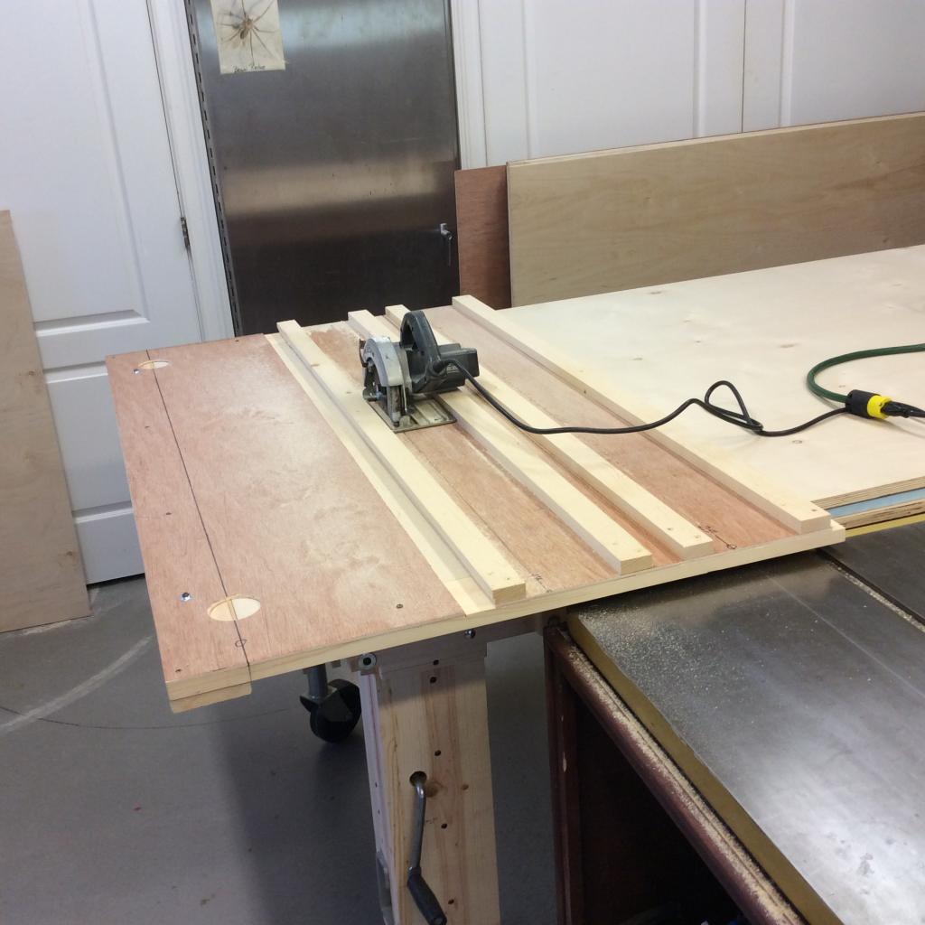

    My latest project is to build cabinets for our laundry room. The requirement is wall mounted floor to ceiling. I've built a number of base and wall cabinets and know the difficulty with handling 3/4 plywood single handed. 6 cabinets will be 4'high X 2' wide X 14" deep and 8 will be 4' high X 2' wide X 2' deep. This is the max size that I can wrestle into place. My Powermatic table saw will handle it just fine but just being able to rip plywood is only part of the task. Not wanting to have to fret with all these cuts with my track saw I decided to build a jig that fits over a sheet of plywood and makes the necessary cuts without all the measuring and clamping a track saw requires. After a bit of tuning this jig cuts the 2 required cuts flawlessly. I know I am not the first person to build a jig for cabinet cutting but can't recall ever seeing one.

    That looks ingenious! I think I can tell it's construction and how it works, but how did you tune it?
      • 3790
      It's hard to see but there are 2 separate tracks. The jig was constructed around a piece of plywood to ensure a square and tight fit with just enough room to slip over the plywood. To tune it I first ran the saw in each track to establish the saw slot, measured and marked the plywood, set the jig in place and moved the tracks slot to fit the marks.

        Well done! Great adaptation of the plywood circular saw jig. I just might need to make one of those soon for a similar task.
