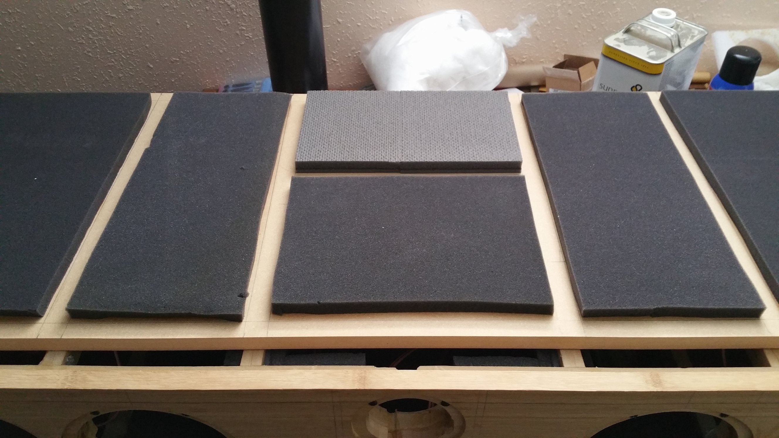

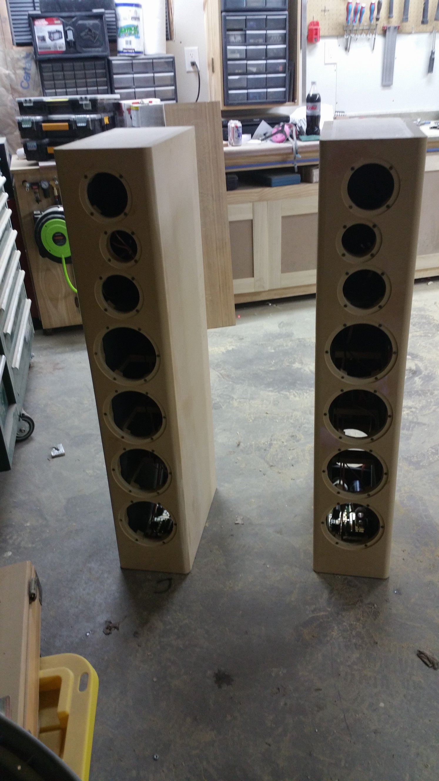

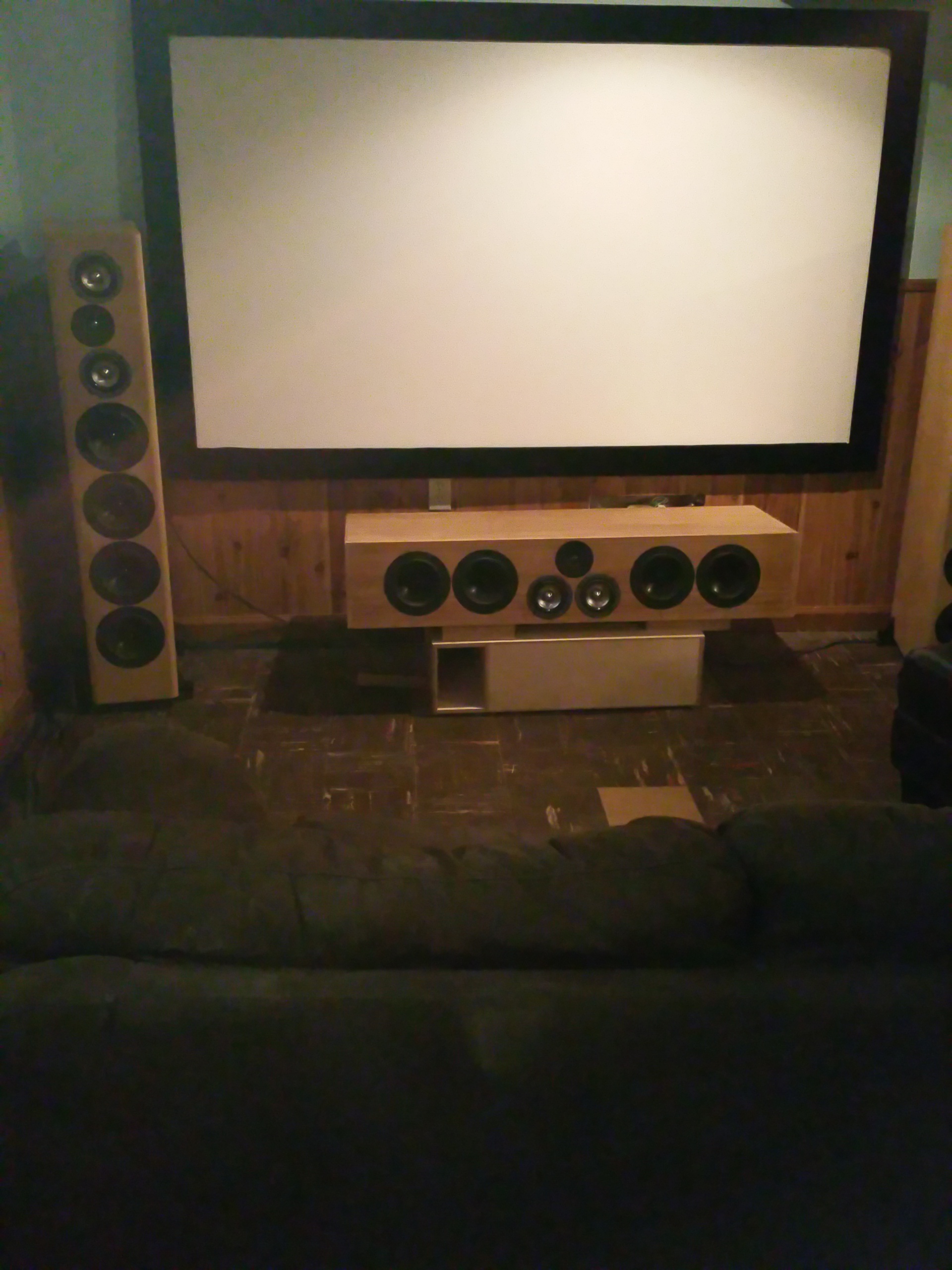

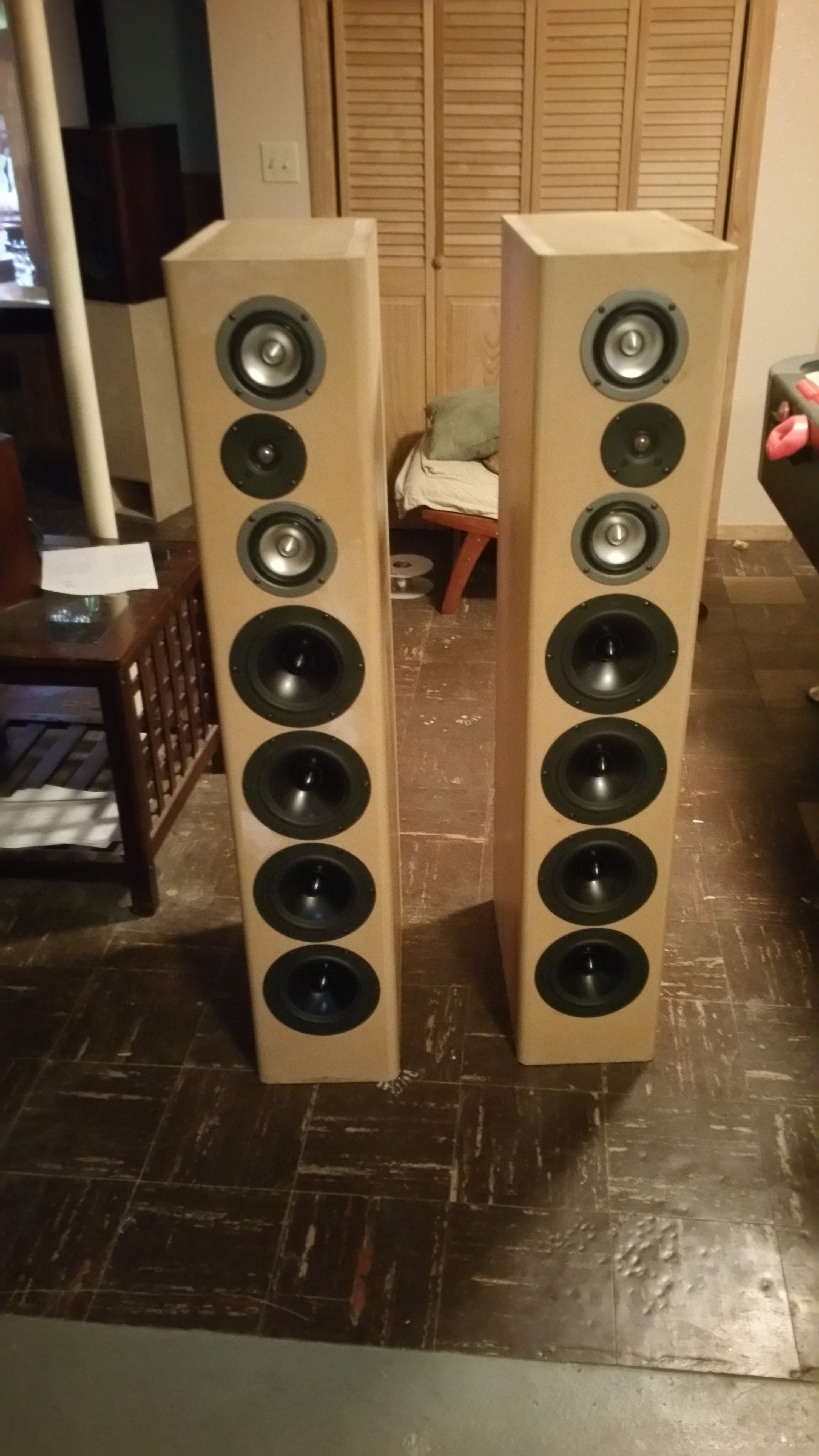

    I've been working on a set of high quality DIY speakers for several years now. I had a couple of stops and starts trying different methods it order to end up with a curved cabinet. Well I decided to just go with a standard build so I can get these completed and move on to another project.
    So, right now they're completely built and they sound incredible. But they're just the raw MDF/ LBL. Initially, I was planning on using this great waterfall bubinga to veneer the speakers, with the goal of making them a real show piece- high gloss finish and all. BUT, with these flanking my projector screen, I'm realizing that the practical approach would be to try to get them to visually disappear as much as possible.
    So, I can go all the way and go with a matte black paint finish, or maybe do something in between and use a plainer veneer like oak or maple, stain it black, and then use a dead flat lacquer to reduce glare off of them as much as possible.
    I'm pretty sure these will be the last home theater speakers I'll ever need. So I like the idea of making them look great. But if their main purpose is for a theater, that's somewhat counterproductive. I guess a middle ground would be to finish them with the bubinga and use a flat finish, but then wouldn't that reduce some of the chatoyance that the waterfall grain would provide? Or, maybe go with a gloss finish and make covers out of a black fabric I can add/ remove as needed? Or should I just go with a finish that's as hiding as possible and make showpieces out of something else?

    Matte black!! Quick, easy, disappear, and usually match whatever decor you have.

      Save the bubinga, use cheap veneer with ebony stain.
      Speakers are not decorations, the less attention they attract - the better, so try to make them blend with the room, not to be a focal point.
      Also - speakers are electronics and electronics develops/changes quickly. Don't bet that those would be your last speakers.

        Maybe flat/gloss black on the sides and then veneer the fronts? You could always cover the fronts with removable black acoustical fabric screens to make the disappear when you want. It would give two looks and you could show off the drivers or keep them hidden. Also would help with dust.

          I would get a plain veneer of a tight grain wood and cover the sides, top and bottom then stain it ebony with India ink. Topcoat with a flat poly or semigloss. Fill the MDF front and back with spackle so it won't soak up paint and for appearance and paint semi flat black. Cover the front with a removable frame wrapped in a good black acoustical cloth. You can use cabinet fasteners to attach the frame or Velcro. Good luck, DP

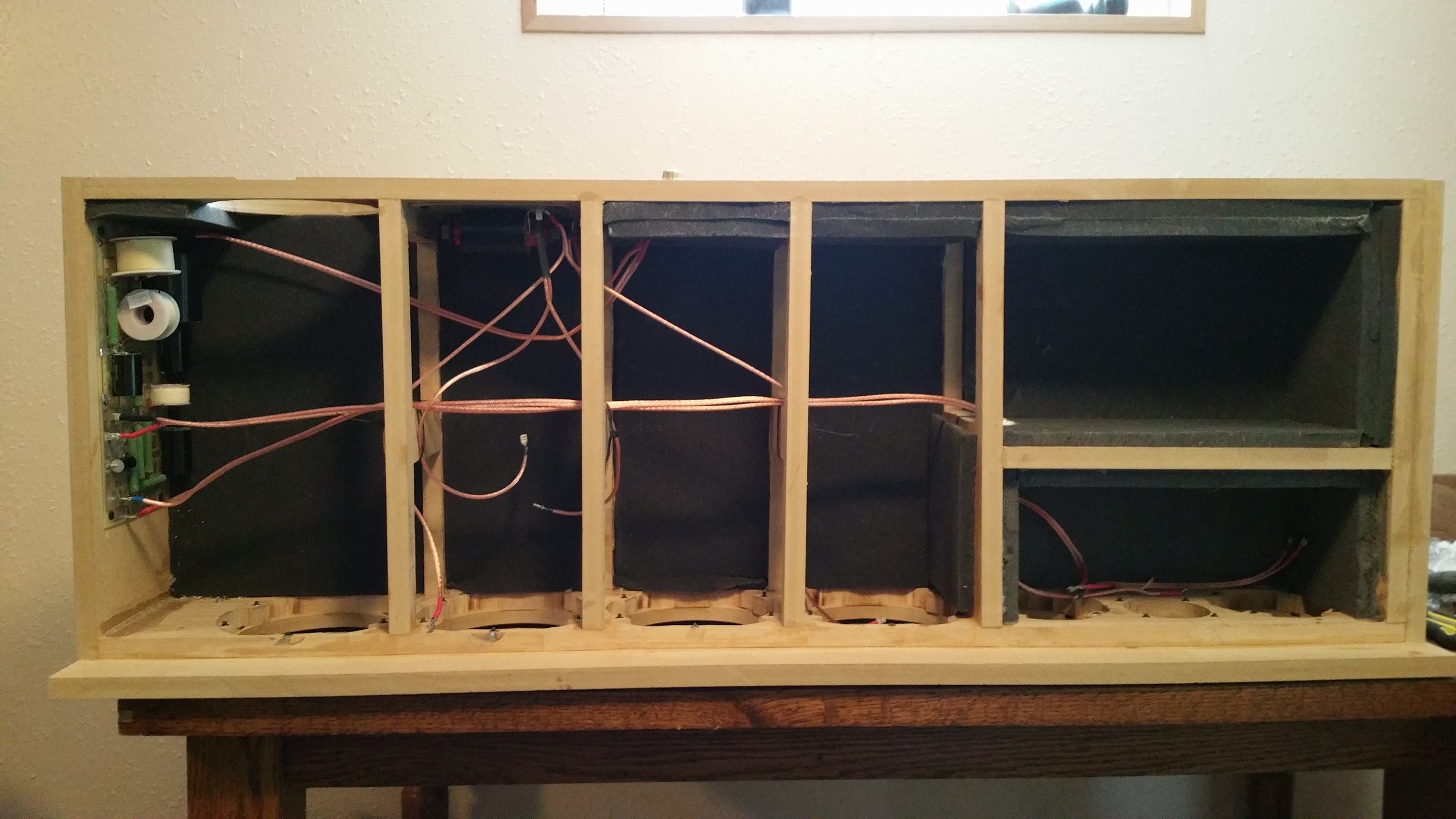

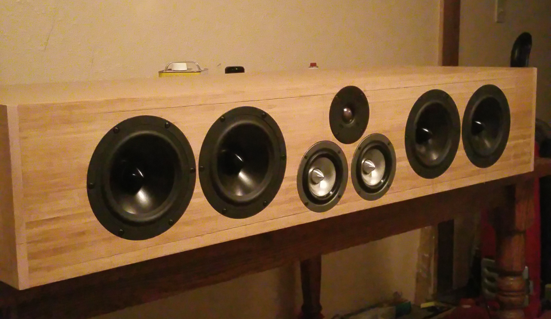

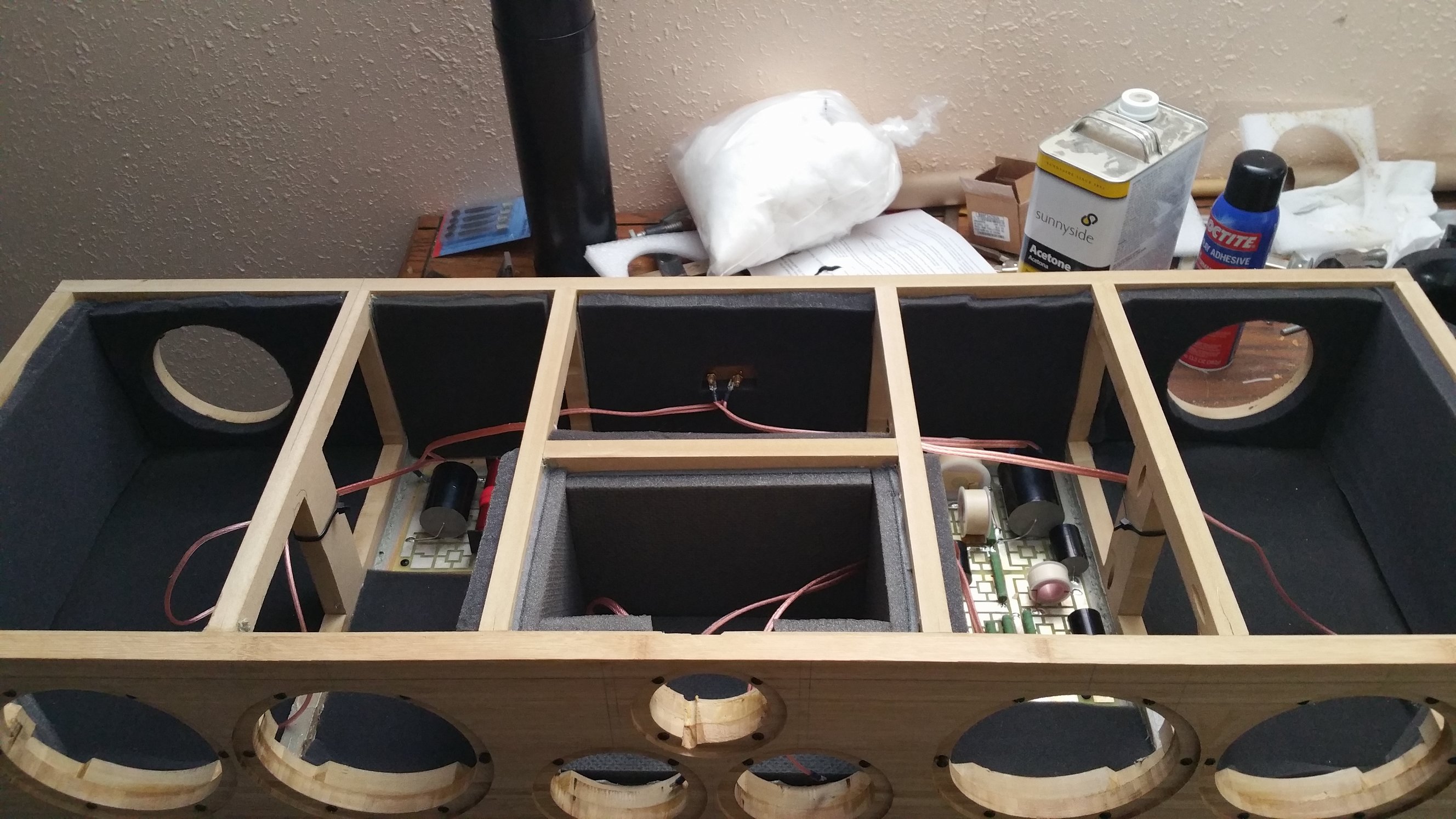

                      The speakers are the Clearwave Dynamic 4TSE and 4CC designed by Jed Kunz.
                      The drivers used in the design are the Dayton Reference series RS180, the Tang Band W4-1337SD for mids, and the ScanSpeak D2608 tweeter.
                      I still have 2 Minuet 5's to build for the surrounds, but I haven't gotten to them yet.
                      Then afterwards, I should probably build the Audax HT center channel I've been meaning to build for the last 10 years.... (the Audax kit was what the Dynamics replaced). That way, I'll have a full 5 channel Audax set that I'll have no use for.
                      But yeah, the speakers sound really amazing! I've heard details I've never noticed in songs I've been listening to most of my life. It's amazing. Now that I have all of my CDs backed up to FLAC and on a NAS, I can stream with lossless quality directly to my system. For movies- I've recently played action movies to demo my theater for some friends, and they're shocked that the rumble they're feeling with no help from a subwoofer at all. These are not small speakers, but they're worth the room they take up.
                      I'm still split on what to do. It seems so far that a lot of people are saying to go with a painted finish. I guess I could build a presentation pair of monitors for my living room, but I'm not sure. I do kinda like the idea of the speaker cloth "sock"... I wonder how much it'd cost to get some sown up. Still on the fence though.

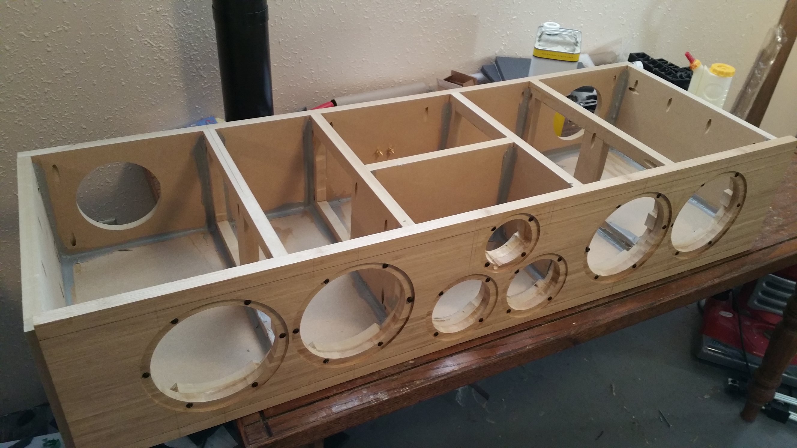

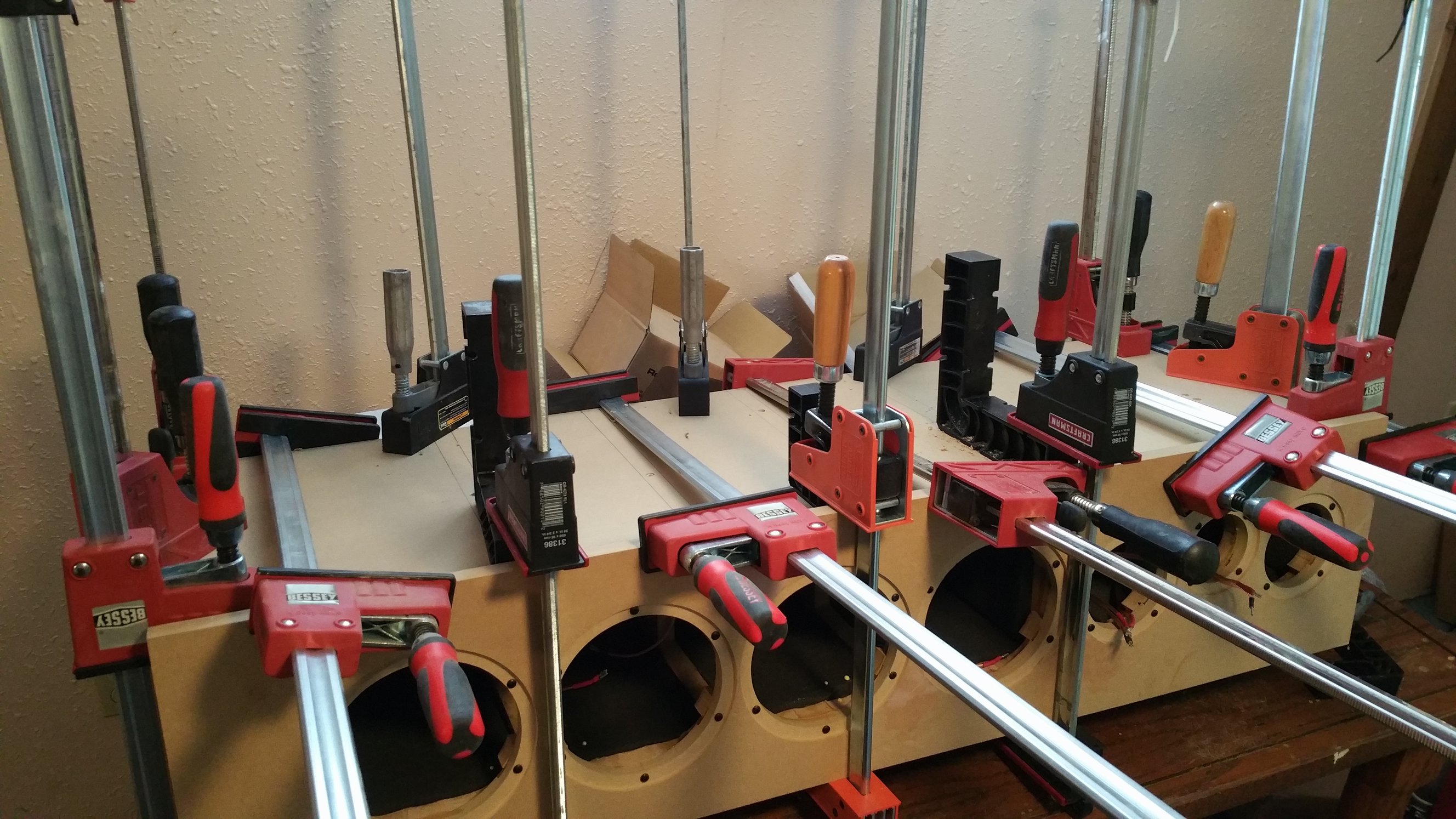

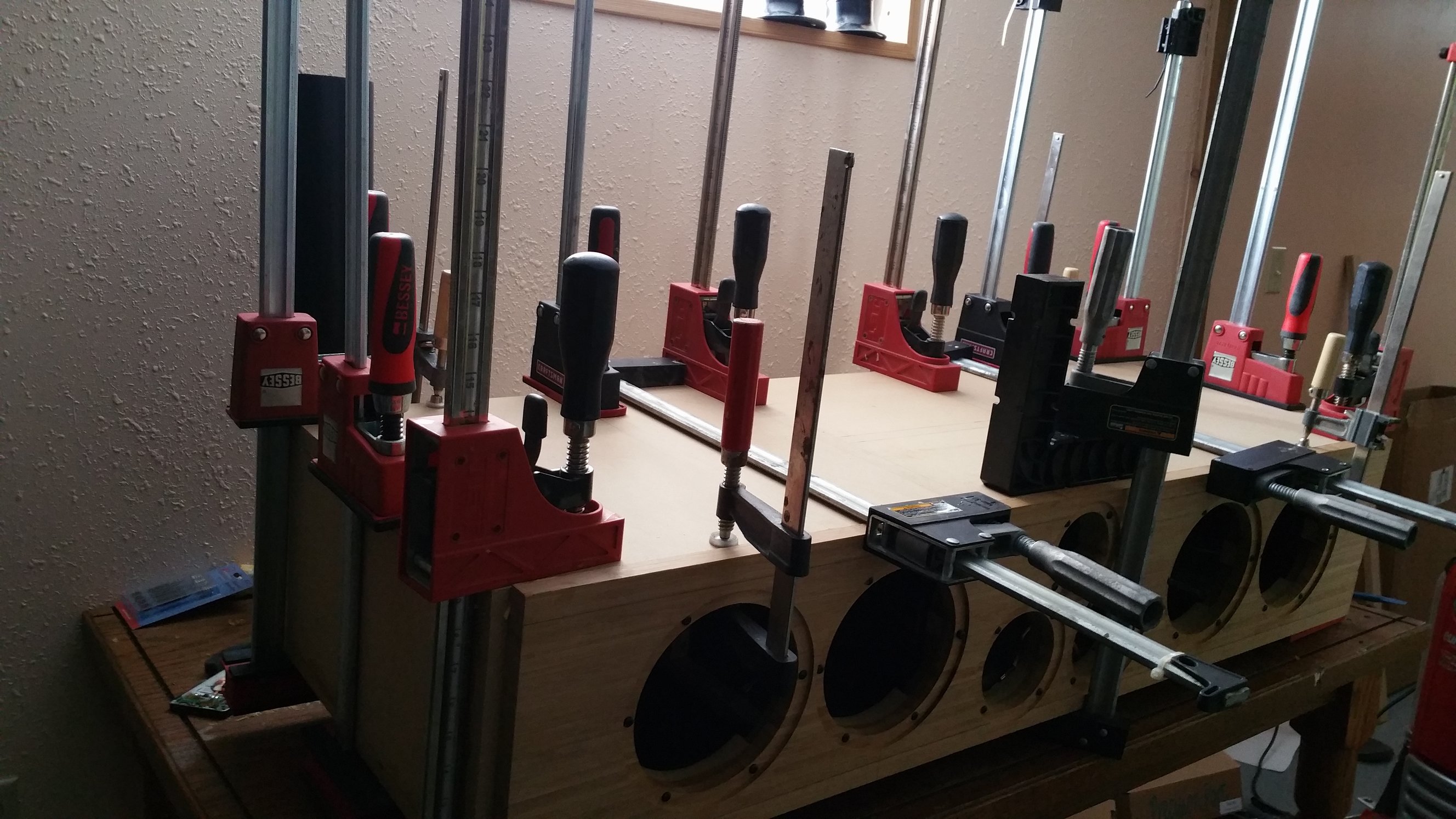

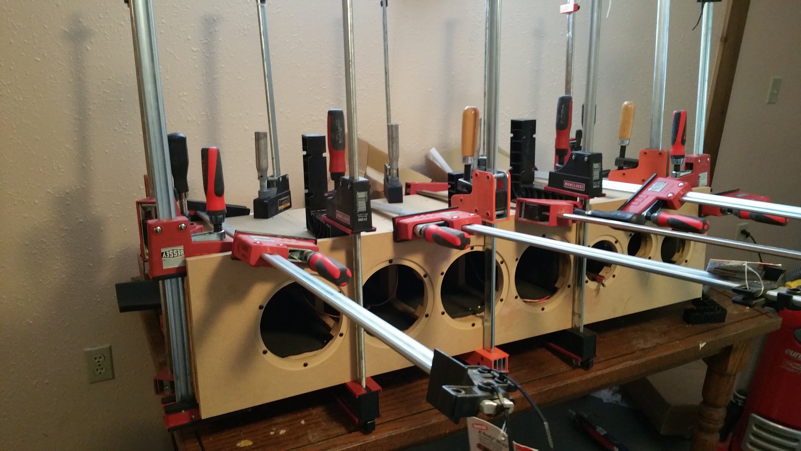

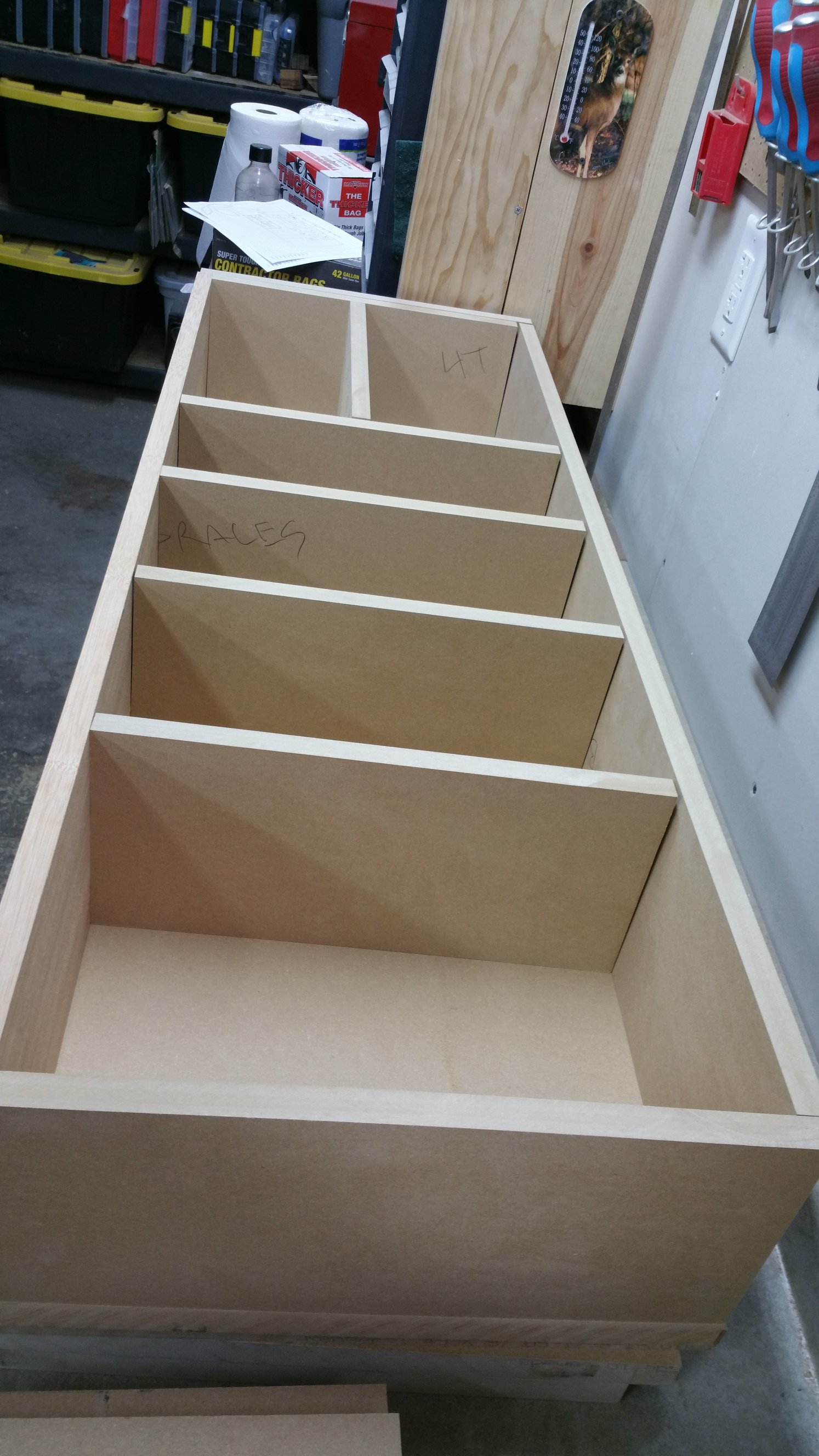

                        BTW- a tip for anyone building speakers... I didn't think to use them during the assembly for the towers, but I used pocket screws for the center channel, and I have to say it's awesome! It allows things to come together so much more quickly! The only time I needed a TON of clamps during assembly was for the last/ top panel. Even then, I used a right angle driver to get a few pocket screws to tighten the middle of the panel down from the inside.
