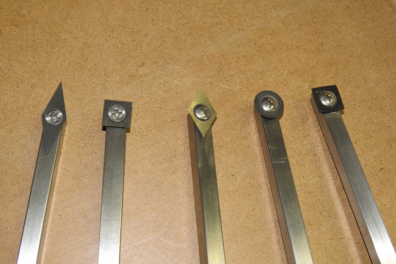

            Yes, good guesses about these becoming lathe chisels. And Jdon is right about the carbide - I still have to drill and tap for the carbide inserts. So I won't actually be trying to shape the steel itself.

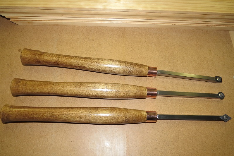

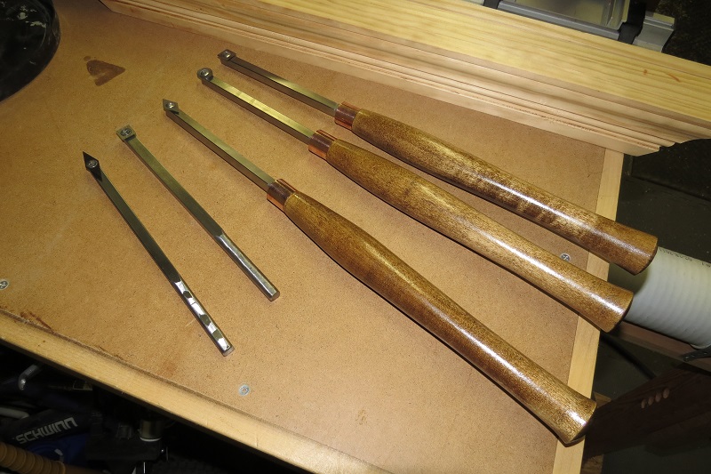

                    I finally had some time to assemble 3 of the lathe tools. I finished the handles with spray shellac, and used epoxy to anchor the steel shafts and copper ferrules. I'll have five tools total when done; I have two more in work (need to finish handles). These were planned around a square cutter, a 4in radiused square cutter, a round cutter, and two diamond cutters. I may add a sixth tool if I get a round sheer-finishing cutter.
                    For the carbide, I went with AZCarbide in Chandler, Arizona. Dale Guilford is the proprietor, and provides a personal touch by contacting his customers directly to confirm their purchase. I found his prices extremely reasonable (much lower than my local woodworking supply stores), and he uses very affordable flat rate shipping ($2) with delivery tracking. The cutters arrived yesterday (see photo showing packaging) - and they appear to be very high quality. Dale provides the mounting screws as well (#8-32, but I damaged my 8-32 tap, so those shown on the mounted cutters are some #10-24 I went with instead). Here's the website: http://azcarbide.com/. Dale also has an eBay store.
                    All told, I have about $50 invested in creating these 5 tools. And I still have materials left over to make the sixth, so that tool will be a "freebie" less the cost of the cutter. So $10 a piece. Each tool is 18inches total length - 12 inch handle, and 6 inches from ferrule to cutter.
                    I received the cutters yesterday, and mounted them to my tools today. I hope to give them a try tomorrow to produce those last two handles I need, and will post my impression of the cutters.
                    Thanks for looking.

                          The carbide cutters I've seen sit in a recess cut out of the bar stock--maybe so the cutter can't spin around? I can't tell from the pics if you did that or not.
                            Paul, they're working great. I just completed my last bowl entirely with these tools, loved how they performed. Another shout out for AZCarbide - the cutters are great!
                            And yes - I ground in a slight recess on the steel bars for the square and round cutters, but not the detailers, since I don't have a milling machine to cut that geometry. As it turns out, a recess isn't really necessary, as the screw used to anchor the carbide cutter provides sufficient friction between the cutter and steel so they don't rotate during use (in my experience). However, I was prepared to use the Capn Eddie method if needed - he puts a drop of CA glue between the cutter and steel if needed, which can be heated later to release the cutter for rotation/replacement.
