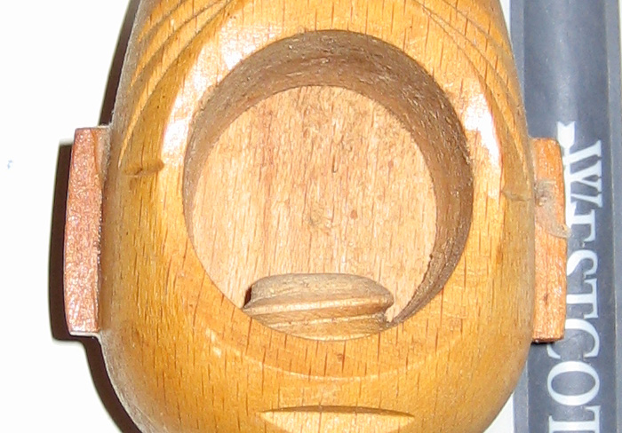

          The hole is 1 3/8" at its widest and 1 1/2" at its longest. Sorry, I should have stated that earlier. It has to be smooth on all internal walls. The bottom can be flat. It is an ellipse. The hole is where the nuts are inserted and a large screw mechanism comes up from the lower internal wall to crack the nut. Will post photo later.

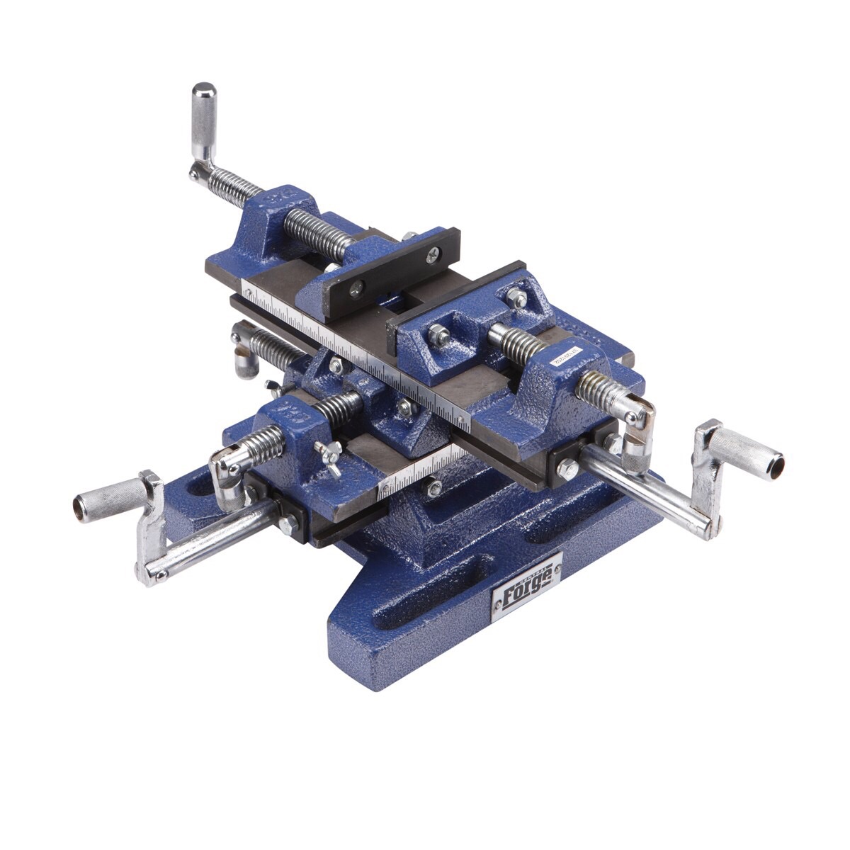

            If you have a mill type vice you can easily stretch a holein the drill press. Done in small steps it is not hard on the drill Chuck. Then run it back and forth to clean out the Spurs. Harbor freights vices are fine for the job and you will find many uses for this vice. Click image for larger version

              Originally posted by capncarl
              If you have a mill type vice you can easily stretch a holein the drill press. Done in small steps it is not hard on the drill Chuck. Then run it back and forth to clean out the Spurs. Harbor freights vices are fine for the job and you will find many uses for this vice. [ATTACH]19770[/ATTACH]
              I have a HF mill vise (I think it is the one you have pictured.). But I'm not sure what you mean by "stretch a hole."

                • 3790
                Start the hole where you want it, index the vice to the desired end of the hole and drill it. Chuck up a straight router bit and clean up the long sides using the mill vice x or y screw, just like your drill press was a horizontal milling machine.
