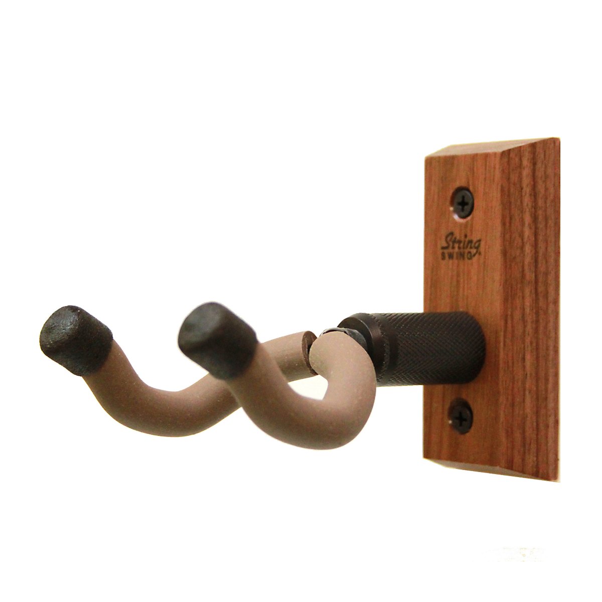

    I am using a guitar hook on a walnut block as a hanger. And these are 2 Ibanez Soundgear active basses. (1 4 string SR480, 1 custom 4 string SR500 with EMG pickups and GHS Bass Boomers strings...) FWIW, the SR500 I own is similar in name and neck design only to the current SR500. My SR480 is closer to the current SR500 except that the pickups are Ibanez specific P / J config instead of the dual J config of the new model. I would guess that they weigh in around 20 lbs each. There is a LOT of walnut and maple in them...

        I am using these guitar hangers from Amazon.
        http://www.amazon.com/gp/product/B00...?ie=UTF8&psc=1
        I was concerned that any sort of drywall anchor would be likely to pull through... Might be worth a shot though... I am very sold on the specific location, just no clue on the mounting method.

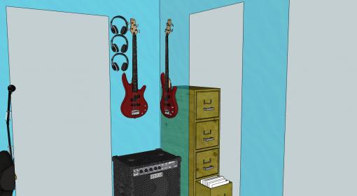

                        Hopefully the attached image can give you a better idea of what I am trying to do. It's the smallest room in the house at 10x11 not counting the closet, and I am trying to maximize space utilization as a home office and studio / music room.
                        The SR500 was honestly, a cheapie from a former coworker in exchange for an Ibanez 5 string I got cheap on Ebay, I was just happy to be rid of it. He was a slap player and had literally worn the original pickups out by repeatedly driving the strings into them. All the wood is in great shape, although the finish on the body like I mentioned, the clearcoat is coming off. I swapped out the OE pickups for a set of EMG P/J-X that I got from Guitar Center on clearance years ago. (Usually $180.00 / set I got them for $75.00), and I threw a new set of tuning machines, and strings at it. I figure with the cost of the 5 stringer, new pickups, tuning machines, and GHS Bass Boomers, I have maybe $250.00 into it, more importantly than budget though, I had to clearance the pickup bores a hair as the EMG pickups are somewhat larger than the Ibanez OEM pickups were. So ugly as it is, my attachment to that bass is more sentimental / pride of accomplishment in getting an effectively dead instrument and bringing it back to life.
                        And the SR480 aside from the GHS strings is rock stock. I bought it when Danny D's Guitars moved from Webster Texas to League City Texas to become Danny D's Guitar Hacienda. Again on clearance, and it was a model closeout before the brought the new model (current model still, even over a decade later!) SR500 out. Prices seem to have come down somewhat. When I bought my SR480, I got it on deep discount, but they were commonly selling for $699.00 and even some places were getting $799.00 for them. The SR500 is going for $599.00 these days, and features the dual Bartolini soap bar style pickups instead of the P/J arrangement. So long winded story short, I prefer the P/J pickup arrangement, so I would MUCH rather keep my existing basses than replace them with the new models...
