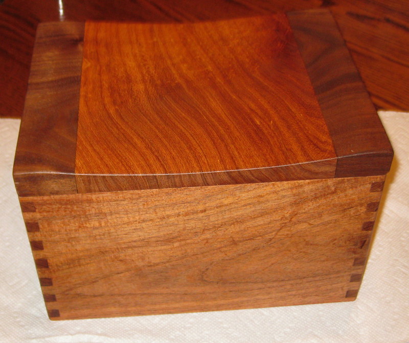

                  My buddy made it home today ....
                  RIP my friend ...

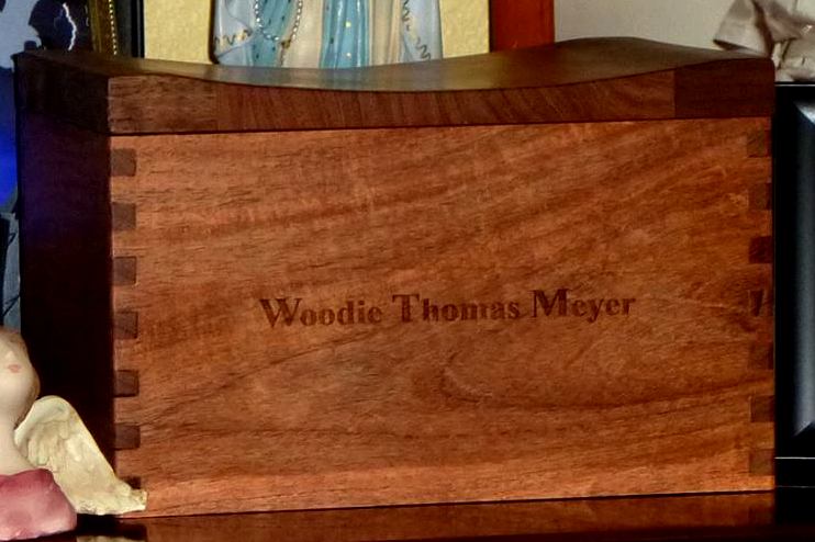

                    • 22106
                    nice touch with the lettering.
                    Looks great.
                      Thank you ... We had it laser engraved ... I thought it was nice.
                      The wood is mesquite because he grew up in West Texas (which is covered in mesquite) and Black Walnut which is what he always bought when we went to the mill.

                            Currently the lid is set with 8 small rare earth magnets ... I told his wife if at some point she wants to seal it just put dots of super glue on the magnets and set the lid back on.
                            The dimensions were exactly as I measured the "temporary box" supplied by the funeral home and fit nicely inside.
