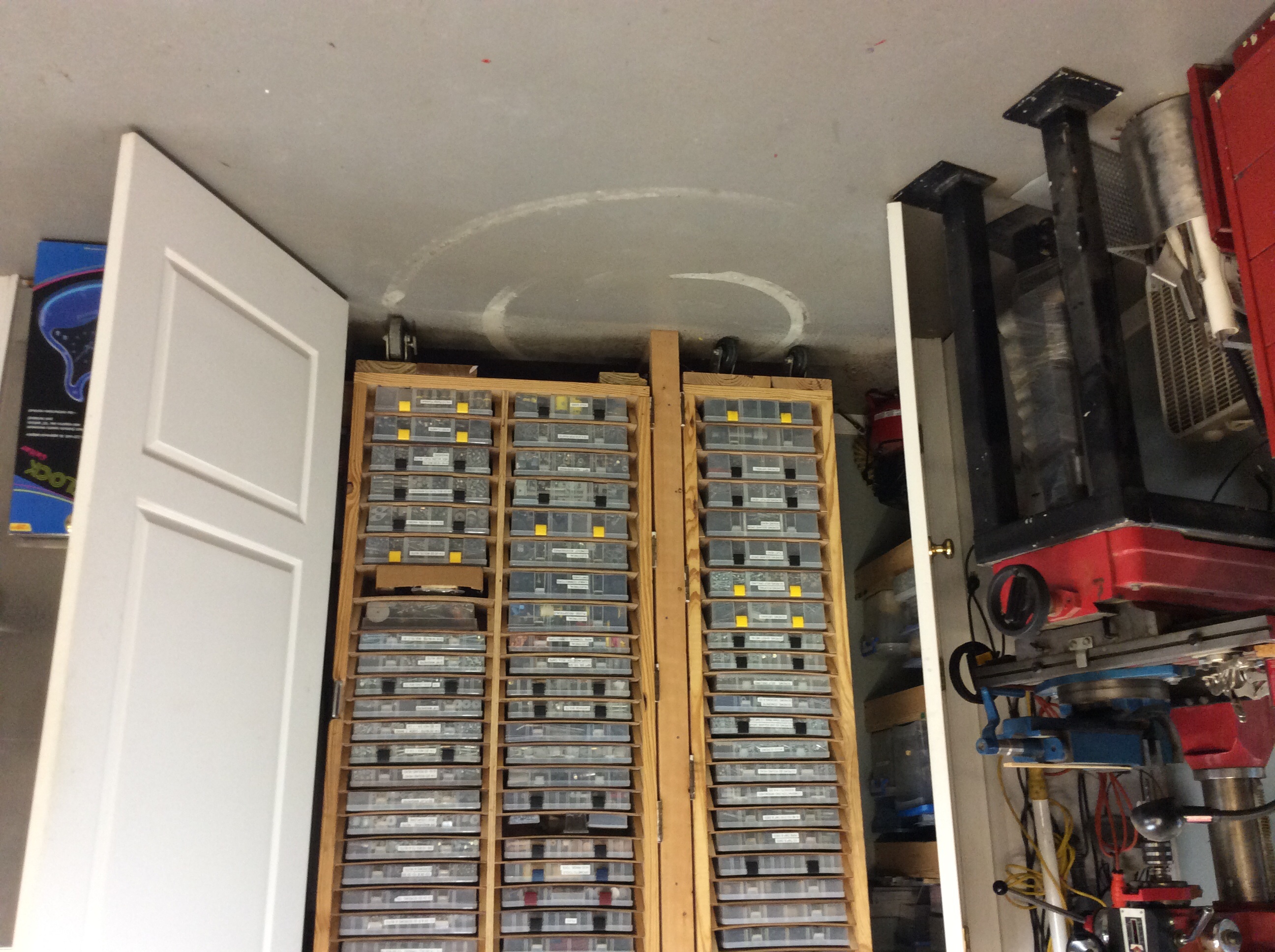

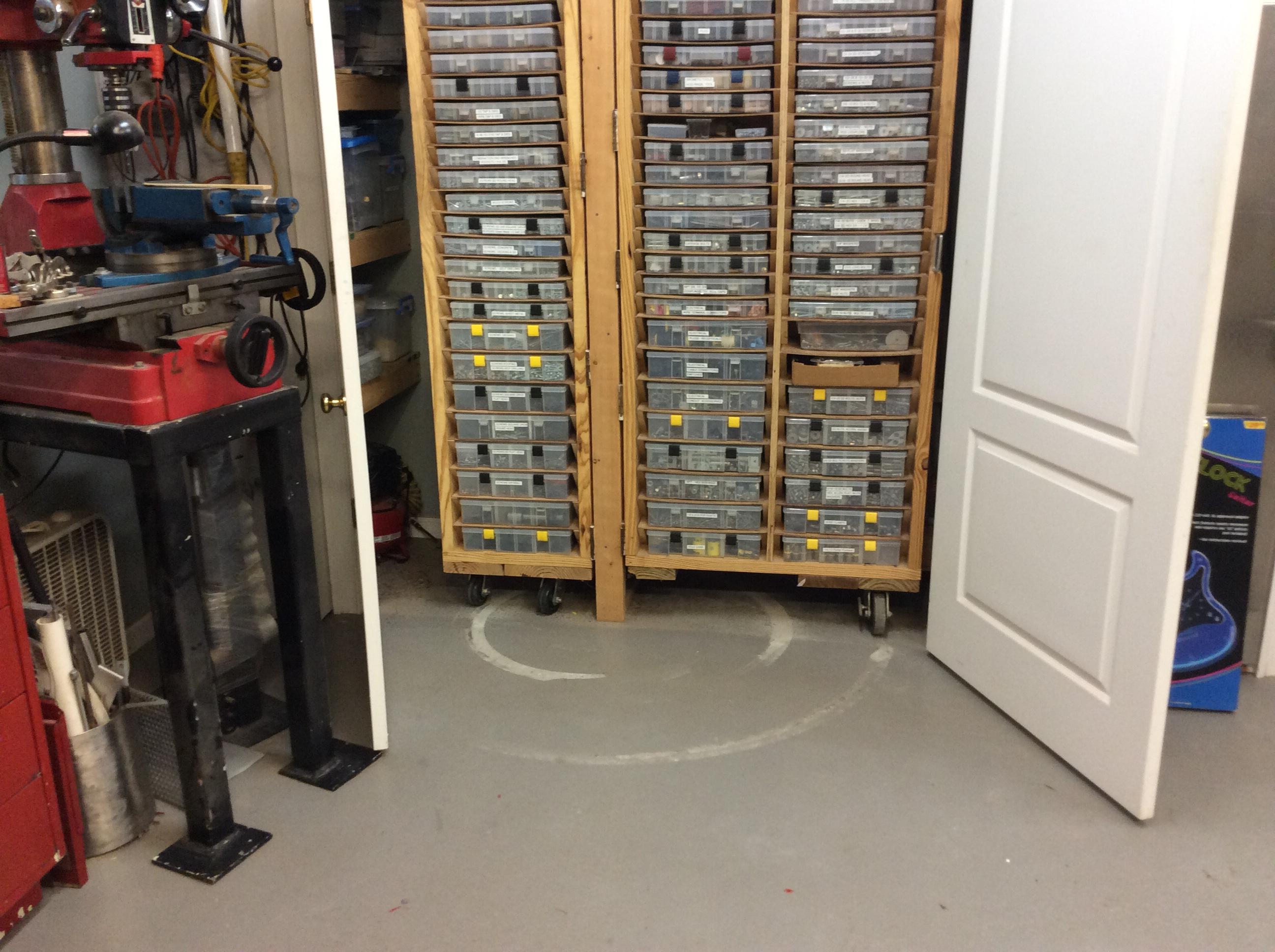

      I got fed up with jars, buckets, cigar boxes and any number of used Tupperware containers full of nails and screws and came up with this shelf sys. for my shop. Each side swings out revealing more of the same type Plano boxes and hanging racks for air hose, larger storage shelves, a slide out drawer for 6' tall stuff. (This photo was previously taken to show the effect of caster weight on concrete). This storage sys is only 24" deep so it is not a space hog. Other than the price of the Plano boxes it was constructed of leftovers from my shop build and cost was nill. This frees up a lot of room that was taken by all the fastener clutter and is used daily. If the photo is upside down, opps, everybody else's computer is still upside down.
