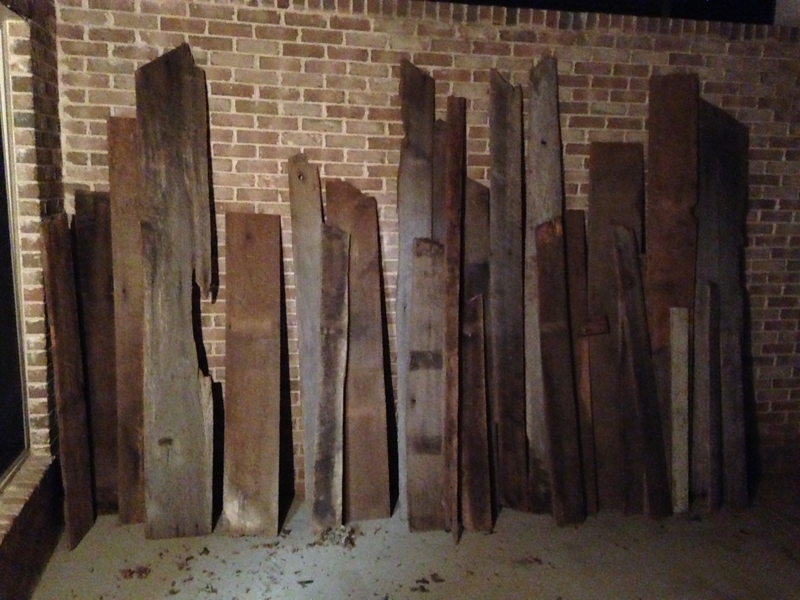

    I just bought a slew of original barn wood from a downed barn that stood during the Battle of Kennesaw Mountain in 1864. In 2004 when hurricane Ivan passed through the metro Atlanta area, the barn finally fell and the current pan owner stored all of the wood.
    Well, now the wood is here in my house. I let it all sit outside for a few weeks to inspect it, brush it off, blow it off, remove extras such as nails, etc., and now I just brought it into my basement.
    My concern is that there may be pests such as termites, mites, etc. that I don't want in my home/shop, etc.
    Does anyone have any advice on this topic? I will say there is much evidence of past pests, such as beautiful worm holes, natural decay, etc. But for the most part, the wood is rock hard and shows no signs of termites.
    Aside from a couple of abandoned mud dauber mud tubes, and a few dead spiders, the wood seems almost petrified and void of life.
    But who knows, could there be dormant larvae or eggs in there that will burst to life and take down my home? SOunds like a horror film?
    Anyway, I would appreciate any advice if anyone has any. Treatment, storage, suggestions for projects even. But my biggest concern is termites. How can I know?

      How are you going to get off the mold/mildew/algae? A dilute solution of chlorox (maybe 20%) would not change the color but would knock down those hazards as well as kill off most bugs. Oh yeah and keep 'em outside while freezing weather is a good idea.

        Thanks for the suggestions. There isn't much, if any mold that's visible. Nor is there algae or fungus. But I did Use an air compressor to blow off any loose dirt, pieces of wood, or just overall dust. Seem to clean up very nicely.
        I will produce a light bleach solution and spray it down. I brought it all inside today on my lumber rack in my shop basement, but will get the energy tomorrow or this weekend to take it back outside.
        Would there be any pest control chemicals that I should try. I realize the bleach would have some effect towards that, pests are my biggest concern not mold mildew or algae.

          I have been working with 100+ year old South Ga. pine barn wood for several years now. I have had insects hatch inside my shop in boards that were stacked. All infestation was on boards that were touching. When stored outside under the shelter insect damage was also noted. It seems that it was only on boards that were stacked with no stickers. The wood borer bee likes these boards too and picks out the best board and bores a tunnel right up the middle of it. None of the insects brought in the shop from these boards seem to bother anything in the shop. I vaccumed them up and dumped them in the garbage can. Any that crawl off probably get killed by the pest control guys roach and ant spray around the walls.
          The biggest hazard I have encountered is hidden nails. A metal detector is a must or your planer is toast. Lead bullets and shotgun pellets cut easily and leave character.

            That's great advice. I'll make sure I use stickers on all. So you think the insects found the wood, rather than were already living in the wood?
            Regarding metal, yes, I will get one, but at the same time, I'm not sure I will plane this wood. It's amazing as it is and I'd hate to plane off the character!

                Seems like I've read somewhere that kiln drying kills any live insects or eggs--one of the benefits over air drying. If true, it would only work for what is already in the wood and not be a preventive measure for new critters!!
