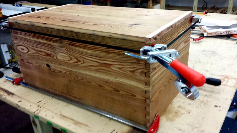

                It looks awesome. Your 4th pic made me think that you box jointed the bottom to the side pieces. Now that would look awesome as well.
                • BadeMillsap
                  • 868
                  • Bulverde, Texas, USA.
                  • Grizzly G1023SL
                  Making progress... Red analine dye topped with wipe on satin poly...

                        You can learn more about long leaf pine here http://en.m.wikipedia.org/wiki/Pinus_palustris
                        The hinges are torsion hinges from Rockler I bought specifically so they protect little fingers.
                        Btw I used milk paint on the inside and intend to distress it a bit before overcoat with ploy
