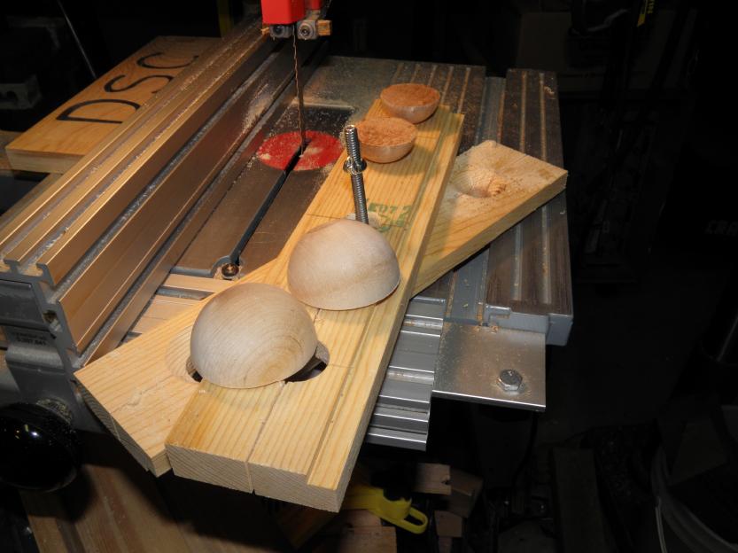

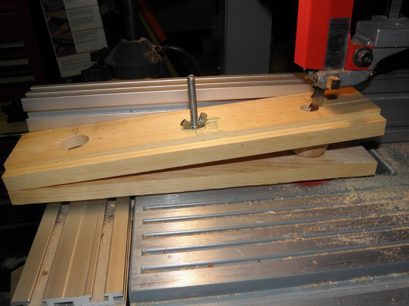

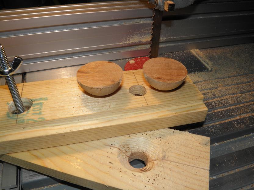

                Well, thanks Natausch. I didn't quite do it the way you suggested but its the closest idea to what I eventually used. I was toying with some way to hinge a clamp with a hole in it for the ball and keep it centered with two sizes balls when I read your post about the long plank and the end serving as a hinge of sorts. I think you intended for the planks to serve as a spring force on the ball but I thought of the bolt.
                I used the carriage bolt and wingnut in the center to be able to apply pressure and vary it as needed. See the pictures attached. The rabbet serves no purpose, it just happened to be on the scrap piece of wood I used.
                I drilled holes appropriately sized for the 1.5" and 2" balls (5/8" and 1" respectively), used a table router with 45 degree chamfer w/bearing bit to make nice seats for the balls (I thought the flat face of the chamfer would grab better and make no score marks that a sharp edge might). Hint: Stacking the boards together and drilling the three sets of holes all the way thru makes them placed perfectly.
                I used the same edge of the jig so its exactly 1.25" from the BS rip fence to the center line of the balls. So I have to be able to flip the bolts. Turns out if you tighten it too much then the jig squeezes the ball and it binds a bit making the blade want to turn. Reducing the clamp force and the feed rate makes it track straight ( I used a 1/2" blade on my 12" Delta BS). One end is for the larger ball and the other for the smaller ball.
                When clamping the ball, just lay the jig on its side to align the sides before tightening.
