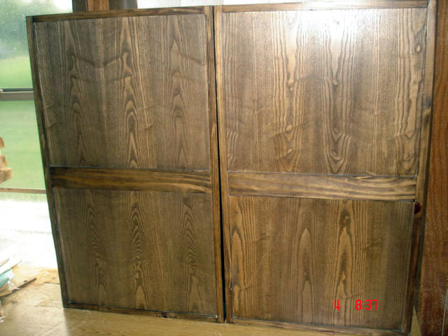

      Strange recipe. I usually just mix some water based poly with water, usually about 75% water / 25% poly. Slap on a light coat, let it dry and sand it off with my choice of grit sand paper.
      Yeah, I know it's a crappy picture, but you get the idea.
        The sealer should have instructions on the can as to how long to wait before a second coat.
        That's definitely the way to do it. The sealer seals the fibers, which in turn means that the stain will penetrate more uniformly accross the project. Dal300's approach is pretty much the same thing, as is using shellac.

            That looks pretty good Dal, I did something similar on the boy's train table last year using a 1:1 ratio of water and GF satin poly to seal and raise the grain. It definitely helped to keep the absorption more even. I was just wowed by the eveness of the color on the magazine panel. It looked like there was no grain color reversal! That is the biggest telltale with staining pine, IMHO... That is what I am shooting for.

              I've had good luck with Minwax redoak stain on pine after a label application of Minwax pre-stain conditioner or something close to that name.
                Wow, I'll say! That came out really good Mark. Maybe the trick is using the manufacturer's proprietary product...
