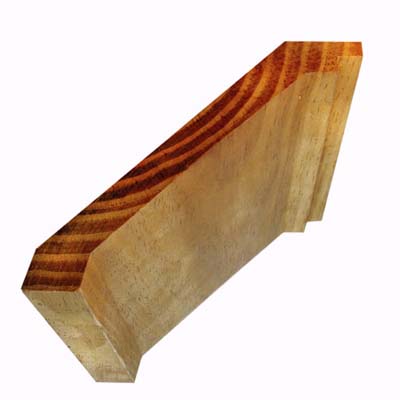

    SWMBO found this online on the This Old House website and wants me to recreate it for our house. I've spent some time trying to figure out how to mill this and I'm at a loss. I could sell my old planer in favor of the Grizzly 15" moulder planer G0477 and a set of custom knives. That would run a little over $1000.
    Any ideas?

      To me it looks like a lot passes through the machines
      2 passes on table saw to clip corners on back.
      2 more passes to give you a 90 off the clipped backs
      2 - 4 passes to hog out the central portion with a dado set
      multiple passes with a rabbet bit in the router table to get the
      top and bottom step profiles.
      If you are going to paint it, You could make it up from 3 pieces.
      a bit more assembly bit less time and waste than all that milling
      You could also go this route if you don't paint but you will need to
      carefully select and match the stock so the grain is consistent

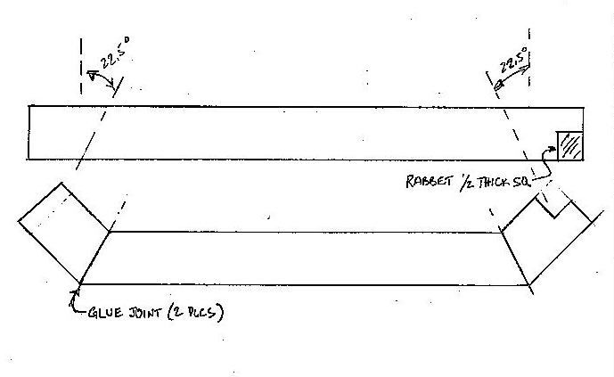

          My suggestion
          here's a way to make this of a single piece of wood so the grain will nearly match and a minimum of milling.
          THe top picture shows the single piece of wood, cut a square rabbet at one end about 1/2 the thickness. THen make two 22.5 degree rip cuts.
          Flip the ripped edges and glue back on.
          saves a lot of wood and a lot of milling.
          Sorry the pic is not quite to scale. and you'll have to figure out the dimensions.
          if the grain is important you'll probably want to get quartersawn lumber.
            Good job Loring, you got it down to two operations and a glue up! I think a gluing jig of some sort would be in order to ensure that the pieces stay straight and on the line otherwise you would introduce a wave into your molding before even installing it! Paint or stain? If paint grade then a jig to align and a few short brads to hold it while it dries.
              I would machine the rabbet on one edge (either with a rabbeting bit, or on the table saw). Then cut the long edges @ 22½° to get the two mouldings (like Loring's suggestion to this point). Then use the one from one edge turned around to fit the other edge. IOW, if flipped and glued on the same edge it came off of, the back side of the wood becomes the front.
              In swapping the two cuts from the edge they were cut, the face grain from the board remains the same.

                  good thought, but its not really possible. Here's the proof: If you think about it, there's a narrow face of the center piece and a narrow face of the outside pieces. In the end, the narrow faces must all be on the same side. But because of the bevel cuts, the narrow face of the center board must always be the opposite face of the narrow face of the outside pieces, when cut. No matter if you flip it side to side, it always has to be flipped top to bottom. Otherwise, the finished piece will be flat!
                  And yes C'n Hack, making a gluing jig would be a good idea if you need more than a couple of feet of this. An excercise for the OPer.

                        I agree wholeheartedly. Maybe she could get excited about a standard crown. Of course if the crown is something to be a shop project to be made instead of bought, you picked an interesting one, but rather plain IMO. In looking at the image the way the site had it oriented, it looks like the rabbeted detail was at the top (as installed).
                        I'm thinking that in most crowns, the decorative detail (like coves or beads) running the length is at the bottom (as installed). This particular crown appears it could be installed either way that you prefer. If you do decide on this style, do a section and position it in place both ways to see which way looks best.

                          Using Loring's idea and then ripping another 22 1/2 degrees from the cutoff (effectively removing a V from the original stock)--the glue-up could then be done with no flipping of anything. It would let the pieces fold in on their natural positions. It would of course require an extra pair of passes for each piece.
                          I've tried to adapt my thinking to Loring's drawing--but the pdf is too big to load. And i'm late for a meeting!!
