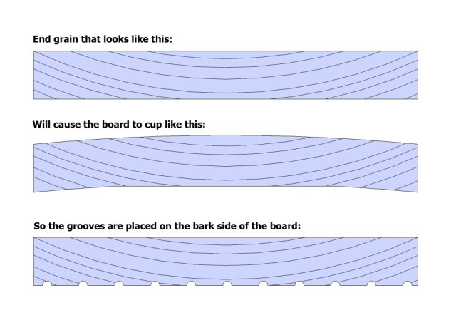

                Originally posted by Pappy
                I do have one question. Ther are grooves cut in the back of the jambs to help prevent cupping. Looking at the in grain of the stock, which side would I want the grooves on to be most effective?
                Generally speaking (because there are exceptions to everything), a board will cup toward the bark side of the tree. If you look at the end grain of a flat-sawn board, cupping will tend to flatten out the grain rings. IME the grooves are usually on the face toward which the board will cup:
                The wood moves most on the face where the rings are most widely spaced, so I presume cutting the stress-relieving grooves on that face is more effective at reducing cupping. Also, the heartwood side of the grain usually has a more pleasing appearance than the bark side, but that factor is probably given more consideration for something like expensive oak flooring than for an inexpensive pine door frame.
                Last edited by LarryG; 12-02-2011, 07:32 AM. Reason: Added drawing to replace crude ASCII "artwork"
                  After too much time looking for info/pics on the web, I couldn't find a difinitive answer. Most jambs I found good pics shoing end grain were either finger jointed or glued up from vertical strips. Stopped by JeldWen doors yesterday and they didn't know. The one cabinet shop I deliver to that has done a lot of custom doors uses all kiln dried hardwoods and doesn't make the relief cuts.
                  Bottom line, still not sure which side is best to control cupping in a solid jamb, but I am going to go with Larry's suggestion.
