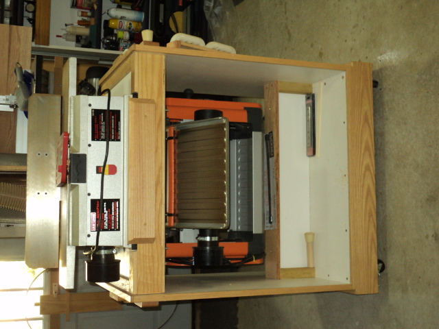

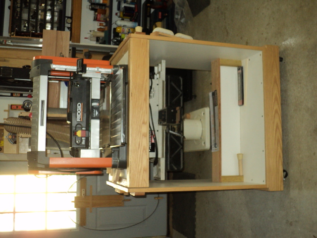

                        This is my set-up. I have no problem needing both planer and jointer at the same time, I joint then plane. Switching from one to the other takes less than 20 seconds.
                        Both items plus the cabinet is very heavy and the wheels I used are to light for the weight. I don't move it often or very far so it's not much of a problem.
                        The items are off-set front to back so the balance is fairly good, I just need to hold on to the table when I pull the stop. When I built this it was to be a prototype, but it worked so well that I added some oak trim and put it to use.
                        Sorry about the picture orientation.
