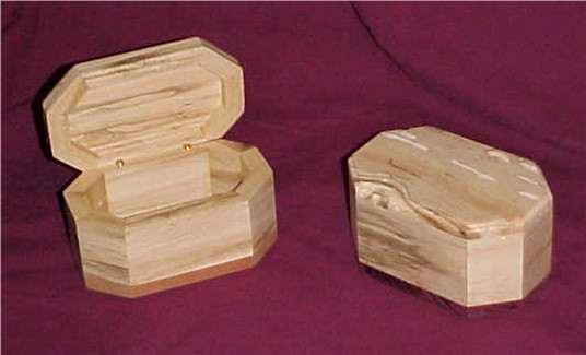

      This box is about 1/2" thick. I used 5mm hinges and chamfered the back side to the outer edge of the holes.

        For 1/2" stock, 10mm hinges will work OK. Barrel hinges can work out to be a great little hinge if installed properly, but offer no adjustment to speak of. Using the correct size will start you off.
        That measurement is easily taken by aligning the two parts together. Using a combo square or a try square, knife mark a line at the centers of both pieces, for both hinges. Then, knife mark the center of the thickness of the two pieces. Now you have drill points. Do the drilling with a drill press. You don't need any fancy jigs.
