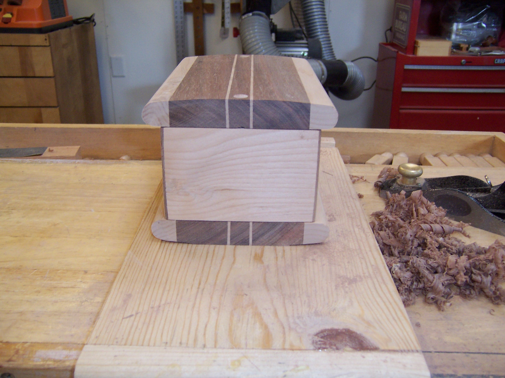

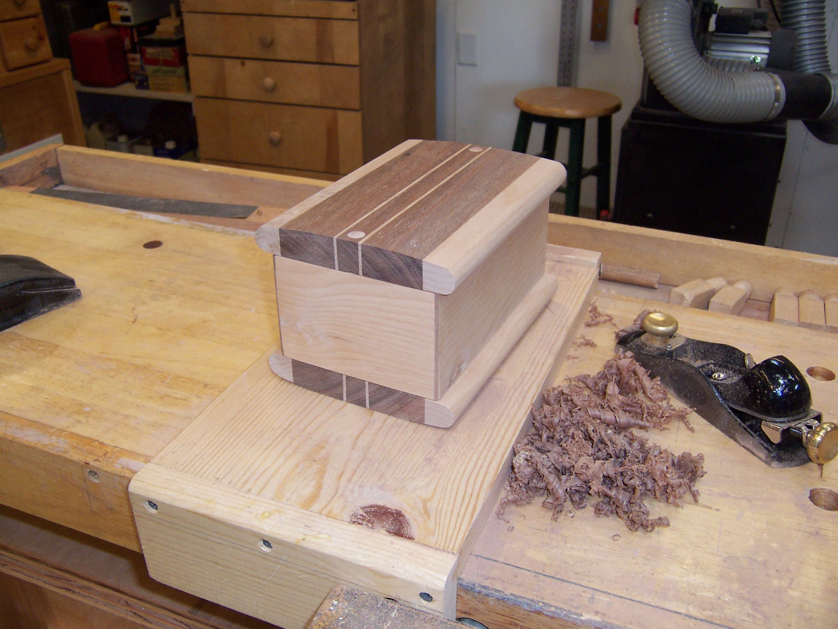

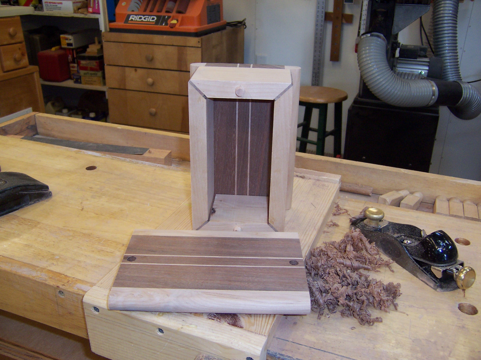

    Another small box finished, this one is soft maple and walnut with no hardware. I plan to finish with BLO and wax, but thought maybe it would look better with a shiny finish on it maybe clear shellac. What's the consensus here?
    Nice looking box. I would probably go with a first application of 50% BLO and MS, and when that dries, a wiping version of an interior oil base varnish. No wax.

      Thanks Cabinetman, any suggestions on the oil based varnish that I could find at the local Ace Hardware or box store?
        For my two cents......BLO/MS, cure for five days, Zinser amber shellac, then a few coats of WB poly.
          Not done anything with maple, since it is such an exotic here in Texas... But with the red oak / walnut stuff I have been doing, I typically have been using the BLO / MS stuff, let it set for about a week, do a second coat, let that cure, and then Minwax finish wax hand buffed. I like the satiny sheen...

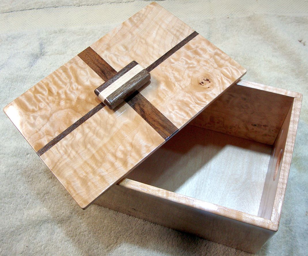

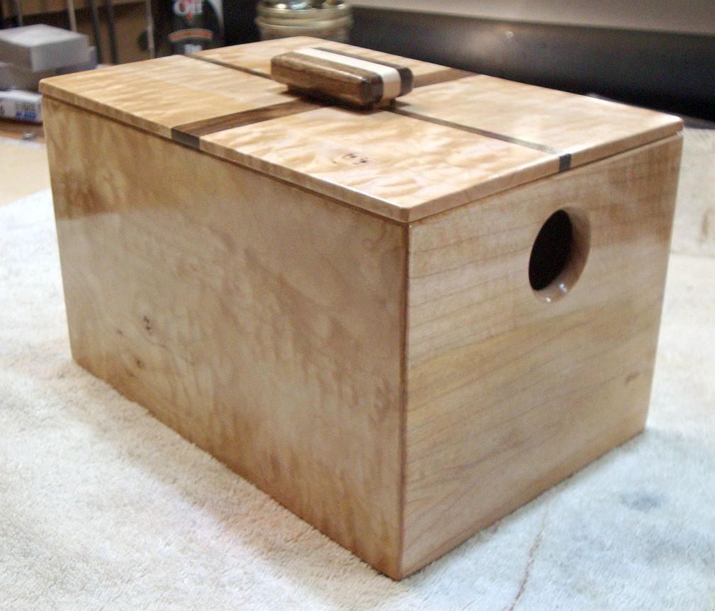

              Here are some photos of a maple and walnut box that is finished with MinWax Seal Coat, followed by two or three coats of MinWax Fast drying poly, thinned 50/50 with thinner so it could be wiped on. I haven't tried BLO, but probably should --- one of these days.

                  Thanks to all for your replies, I guess there is no 1 only way to finish a piece of wood. I am going to experiment (not on the box) with several of the suggestions. Steve, great looking box both construction and finish. Is that what is called quilted maple? As dbhost stated we don't have much maple available in Texas.
                    Thanks for the compliment. I really lucked out on the maple - - I found it at the Borg. Every once in awhile a really nice piece of wood sneaks into their stock.
                    The box is assembled using lock miter joints, no metal anywhere. The handle on the top is fitted with dowels and the maple and walnut pieces are just glued together.
