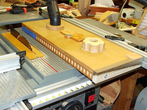

          This is the geekiest contraption I have ever made, but it works.
          ShopVac thin strip jig: 1/8" plywood base. 3/4" MDF top and ports. Blue tape covers the unused ports. If the strip is too thick, rip it again. The vac holds it for multiple passes.
          (Pardon the clutter on my outfeed table and work table - no excuse)
          - Lonnie

            Originally posted by Lonnie in Orlando
            Loring -
            - Lonnie
            Cool jig! This confirms one of the reasons I joined this great forum!
            Thanks,
            J.D.
                    Loring -
                    - Lonnie
                    Terrific jig, Lonnie. I think I may try that.
                    Richard
