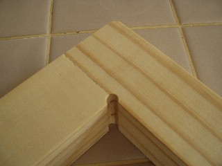

                      Make your own assy squares:
                      approx 7-8" 2x2s ripped from 2x4's jointed and planed to be square and square in both senses of the term. get it down to about 1.5" square and that's perfect. Use straight-grained parts of 2x4s with no knots or defects.
                      Carefully cross cut at 90° then butt-joined. In addition to glue there's two 3.5" screws into the end for strength. Checked for perfect right angles before the glue sets. Drilled out the inside corner (1/4") and 1/4" chamfer the outside corner for glue relief so it doesn't stick to any assemblies that might ooze a little glue. Break all the sharp edges. I have four of these.
                      The $12 Rockler ones are plastic and early on they had some issues with being perfectly square. Its said that's now fixed though. But I trust mine more and they cost practically nothing to build in a short time.

                        I like that idea! I am going to have to print it out to .pdf and save it for later reference.
