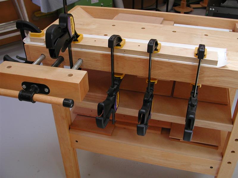

          WARNING!
          I have done this many times (only once unsuccessfully).
          I use Titebond II - Do NOT apply the glue to the sandpaper - apply the glue to the "wood", then clamp for 24 hours and trim it up.
          If you apply glue to the sandpaper, it will buckle (permanently), before you can lay the wood on it - trust me.
          Downunder ... 1" = 25.4mm
