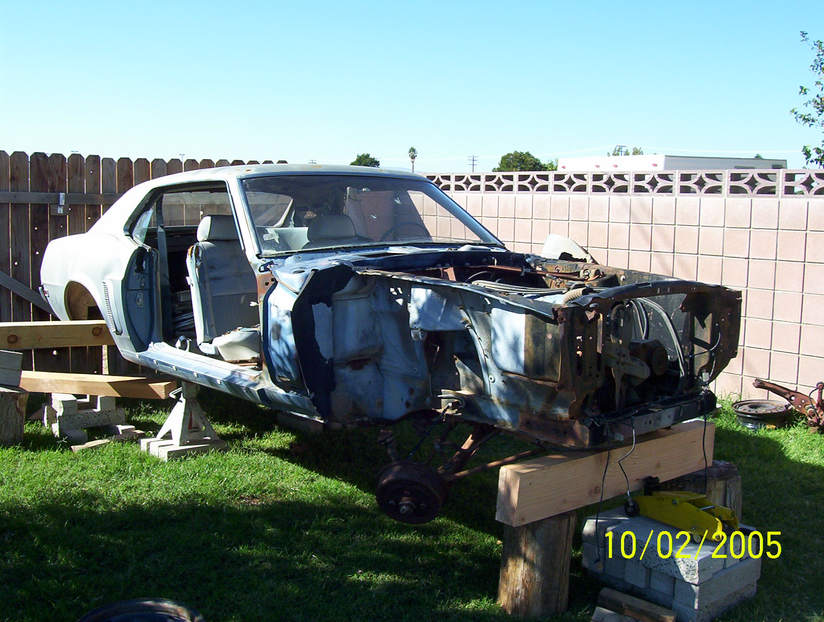

                        A mustang of that year just has to have a set of Cragar S/S's or its just a grocery getter. Of course my engine work would get you there pretty fast. Here is what I started with. There were many times when i would think." If this was wood i could make that and save some money and it would look nicer". Notice my wooden suspension. At one point I had to turn the body around So I bored a hole the size of my bottle jack piston in a beam like you see and found out where the center of gravity was. I jacked it up and walked it around by myself. I had my son hold it still during the raising and lowering. It may sound goofy but if I hadn't have ever started woodworking a lot of the things I was able to do wouldn't have been done had I not been able to think through a problem like I was working on a piece of wood.
