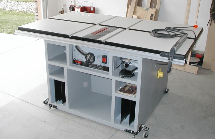

                        That was one of the primary reasons I built Sawzilla.
                        I wanted an extended outfeed table and the ability to cut large sheets of ply without support stands.
                        But it did create a large cabinet saw.
