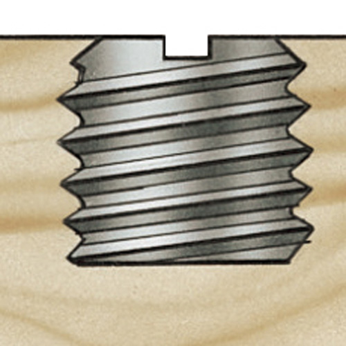

    I'm finishing up my drill press and router table and am having problems getting the threaded inserts to start / stay in. I'm using Rocklers insert for a 5/16 t-bolt but in using a 3/8 (recomended), 7/16, and also 1/2 guide hole I can't get them to thread in. I also built the jig they had in wood magazine that centers a vertical bolt w/ washer and double nut over the insert then using a ratchet and still no luck. I've also tried different woods - birch ply (the tops), poplar (fences), and oak (hardwood test).
    Going down the list I've tried wood titebond, construction adhesive, epoxy, and gorilla glue in the process but none of them stop them from spinning. Such a simple concept but do they even work in birch plywood / do I need a different brand / what am I doing wrong ?????

      Screw thread ... if you hammered them in why would you have a screw thread / screw w/ barbs on the thread / screwdriver slot on both versions on the top of them ????
      I sure would love to take a hammer to them that's for sure
      From Rockler's website:
      Made from steel. Size listed is the size of the internal machine threads.
      Sold in pack of 8.
      Can be installed with screwdriver, threaded insert wrench or threaded insert power drive tool.
