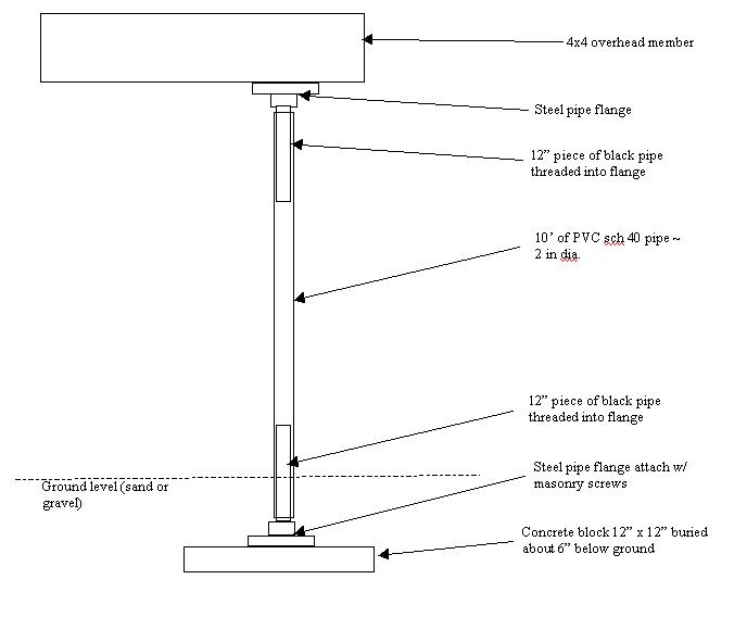

        Here's my best thought:
        (click to enlarge). The pipe can be removed and replaced easily by unscrewing the upper flange. While its loose and free to rotate, and give a little if someone runs into it, it is held quite stoutly by the pipe flanges.
        In the picture there is no load hanging from the overhead, I guess it could be a 2x4.
        Another way, if you feel the need to hang the load from the beam, you could shorten the internal steel pipe, drill the steel pipe and PVC pipe and fit a 3/8" bolt through them near the top that would keep the PVC from rotating.
