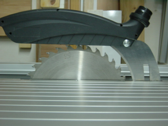

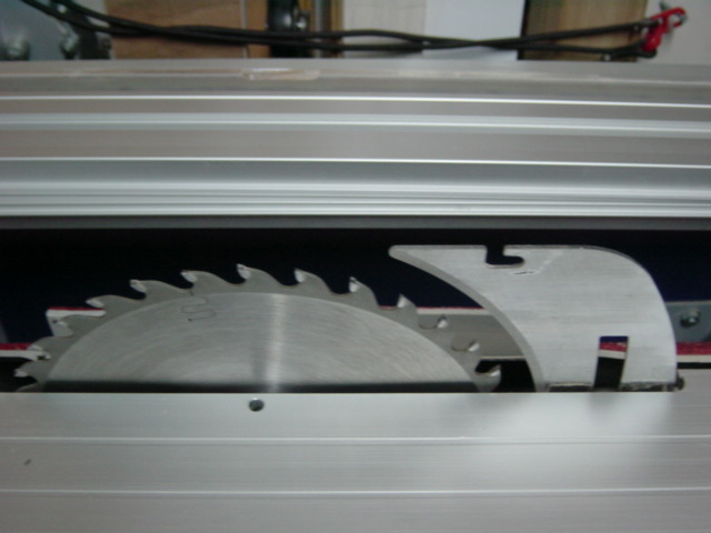

    Thank you Lee
    The Instruction manual calls for the RK to be 5mm from the blade.
    I can set it Higher but that the distance is 15mm.
    For the sake of safety, I prefer to follow the instruction and lose the extra 1" that till now, I did not need anyway.
    I just made it and took the pics so you can see what I mean
    Chris
    I'm too "small" to unswer your question.
    niki

        Niki, I see that you are trying to keep the knife level on top. Will the knife lean in closer to the blade? I noticed on the Laguna, that the top of the knife wasn't level.
        I would probably use your saw the same way you do if I had it. It makes more sense to me to set the knife lower so it doesn't get in the way. Especially since you use a guard. The guard would help prevent upward lift of a higher blade anyway.
        I just realized that your guard does indeed need the knife level to work right.
        There is one big thing I have come to know. There is no consistency between manufacturers.
        • niki
          • 566
          • Poland
          • EB PK255
          #34
          Thank you lee
          I checked it again
          The RK can move up/down or forward/back but cannot be leaned to any direction, so what you see in the pic is the closest position to the blade (almost touching the blade at the bottom).
          The guard can move a little bit up/down but only a little bit, maybe that's the reason that I cannot lean the RK as you said.
          niki
