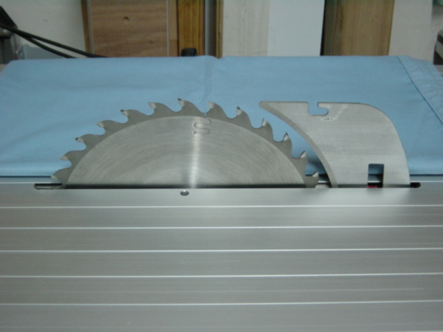

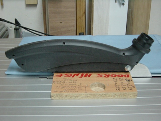

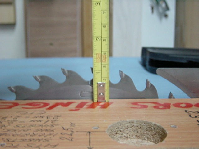

            I don't know what kind of blade guard everyone is using (or not), but when I put my blade guard on the riving knife, it covers about 1"~1½" of the blade, so if I set the blade to minimum height for the board thickness, it's actually around 1"~1½" above the board.
            I attached 2 pics from other post,
            On the first picture, you can see the blade guard just above the board.
            On the 2nd pic, I removed the guard, to take the next picture (but did not change the blade height).
            The board in the pic is 3/4" melamine so you can judge what is the blade height.
            Normally, I work with the blade guard installed, and because I don't see the blade, my eyes are automatically diverted to the fence to watch for any deviation of the board from the fence.
            In the very few cases that I work with the guard removed, I noticed that my eyes are concentrated on the blade, and I know that it's not correct and I have to watch the fence instead, but the blade is more scary so I'm looking at it...
            I would like to advise to work with the blade guard installed and than, the eyes will look wher they have to look, at the fence.
            Looking at the blade will not tell nothing about impending kickback...

                  I really cannot understand the Freud recommendation on the blade height.
                  If the recommendation is for "no guard", it looks like Frued is telling us not to install blade guard (which I don't believe)
                  If it's with Overhead guard or alike, they have to declare that "this blade is designed for use with overhead guard only".
                  But for blade guard like I have, that covers the blade 1½", there is no other choice but to set the blade 1½" or so above the work.

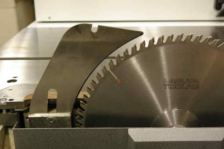

                              Niki, I don't know if you are using this correctly or according to the maker. It may be that different makers say different things about how to use these type RK's. Just the other day, I was working on a conversion for a 12" Laguna TS. These have a RK very similar to yours.
                              The owner of this saw stated that Laguna recommends against lowering the knife so that it is below the teeth. This is how we all like to use a RK and therefore there is less of a fiddle factor involved with it.
                              I feel the sole reason they suggest this is because of the location of the guard when feeding stock with the knife set so low. If you raise the knife up when attaching the guard like Laguna recommends, then you would not have as much blade exposed when making a cut.
                              Your manual may be different, but this is the cause of you not being able to lower your blade more. Your knife is too low when the guard is in place.
                              The Shark is designed with the barest minimum distance from the top of the knife to the bottom of the clamp that holds the guard. The guards bottom is in the same plane with the bottom of the clamp. When set right, there is no more than about 3/8" blade exposed when making a cut. It appears as though your guard and Laguna's as well uses a lot more Real Estate from the top of the knife for mounting it.
