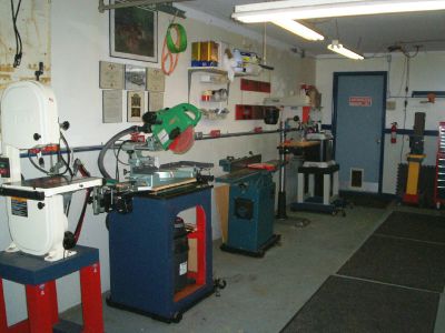

                  Southern yellow pine for tool table bases is an excellent choice. It's actually qiute dense for soft-wood and will take a lickin'. Remember that it's a tool table your building. My assembly table base, base or 12" curve BS, base for planer are made of southern pine laminated with 3 coats of Porch and Floor paint on them. They will be around long after me..
