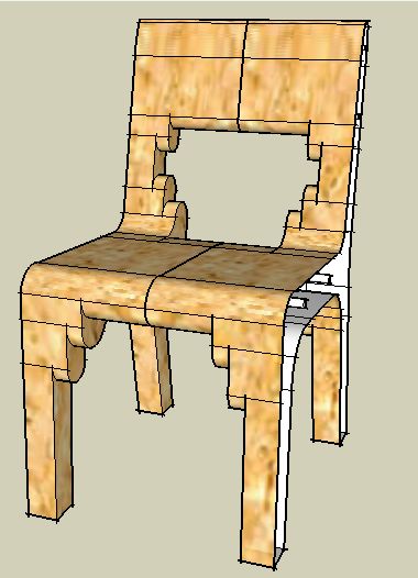

    Our local woodworking group has a yearly challenge. I guess it would be similar to the 2x6 contest here. (Last year it was a 2x4 contest.) This year, it is a half a sheet of plywood contest. You can use whatever thickness of plywood you want, but just 16 square feet of it. The piece I am designing would be much better with thicker wood, as it is going to be built up by gluing cut out shapes of the plywood together, with the edges exposed. A sheet of 3/4" is going to be cutting it very close. I would prefer 1" or slightly over. However, I have never seen this before. Does 1" or 1-1/4" 5-7 ply plywood exist? If it does, where does one pick up a sheet?

              I built a quick prototype on the scrollsaw, at 1/4 scale. The actual chair will be 17" wide (17 pieces of 1" ply, so just under 17"). This only has 12 plys, because I cut out 5 of the back and seat pieces that are the same. I mainly wanted to make sure that the design I made on paper looks decent as a chair in three dimentions.
              Each layer alternates, so the two legs layer on each side will be 90 degrees apart on surface grain. This should give me the effect of over 100 alternating layers making up the chair, with the laminations of the actual plywood sheets unable to be picked out from the actual laminations inside the sheets. I think it will be an interesting look.
              I plan on using small aluminum tubes to align the seat and back, then threaded rod to provide clamping pressure. These will be inside final outside ply. Once that is dry, I will clamp the final outer layer onto the side, which will hide these holes. I'm not sure what to use for final shaping. I've heard abrasive tools work better on plywood and some have used an angle grinder for this type of work. Not sure if that is better and a surform or something similar. I think I will add a little ridge underneath the seat for little larger space between the compression and tension forces. Although 3" is a pretty thick seat to begin with. Decisions, decisions.

                From the prototype, I think it will look pretty good. Using most (?) of a half sheet of 1" plywood, is it gonna be a bit on the heavy side?

                    It will be heavier than your average chair, that is for sure. I think the majority of the seat strength will be from the portions within 1" of the top and bottom of the seat, as those will be the main places for tension and compression. So I may drill out a little more in the center, in an offsetting pattern. From the patterns that I'm coming up with, I believe the initial rough glue up will be about 75-80% of the sheet of plywood. After rounding and final shaping, I think I'll be down to 60-70% of the half sheet. And it won't be the weight of a whole bottle of glue. It will be the weight of a whole bottle of glue that has been dried (that will save a couple ounces over the wet glue). OK, maybe a bottle and a half.
                    I've heard of 25 lbs per 1/4" for a full 4x8 sheet. So I would estimate a 4x4 sheet of 1" would be around 50 lbs. 50*70% = 35 lbs. That is heavy, but not overly so. I think of it like a mix between furniture and sculpture. If I can find the right stain to contrast the end grain from the side grain, the look will be striking.

                          I'm thinking about glue up time with the main assembly. I don't think I'll have enough working time with standard Titebond II or similar. What glues should I look into that would give me enough time to spread it on 15 layers (58 seperate surfaces), assemble and clamp? My plan is still to use two pieces of all thread through the seat and two more through the back to clamp those pieces and use blocks with washers on the outside. There will only be one outside layer on (legs and run up to back), so the last layer will hide those holes. Hmm. Reading the links for Kerry Vesper's work, he seems to glue and screw the layers together. I guess if I mark each screw location, I can run a three layer stagger. That would also reduce the glue drying issue and I could use standard Titebond II.

                            I decided that drawing this in Sketchup would be the easiest way to put grids on the patterns to allow me to scale them up. Having Sketchup would have saved 2 hours of work to get to the 1/4 scale prototype. I could see what it will look like in 30 minutes work. I didn't close the outside edge, because I want the sections clean for patterns. I just drew all the profiles on one layer and extruded them to different depths. Then I copied half the chair and scaled it for a mirror image. Grouped each side with its parts and slid them together.
