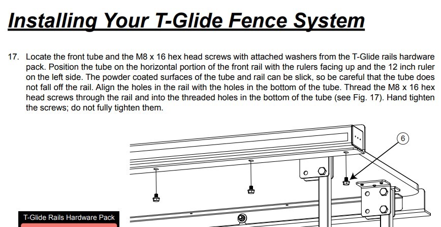

        If I’m not mistaken the rectangular tube is welded to an angle of the same length. It’s what bolts to the table. There are several cut outs in the angle stock for T slots, no big deal but not to be forgotten. There is also an angle attached on the rear of the table and is necessary when going with a wider system.
    • Stan
      • 966
      • Kalispell, MT, USA.
      • BT3100, Delta 36-717
      The tube that the fence rides on and locks down to is not welded to the angle that is attached to the saw front.
      The rail tube is attached to the angle iron using screws through the angle iron and into the bottom of the rail tube. Click image for larger version  Name:	T-Glide assembly.jpg Views:	0 Size:	102.0 KB ID:	852871

      Correction, the rectangular tube is bolted to the angle.

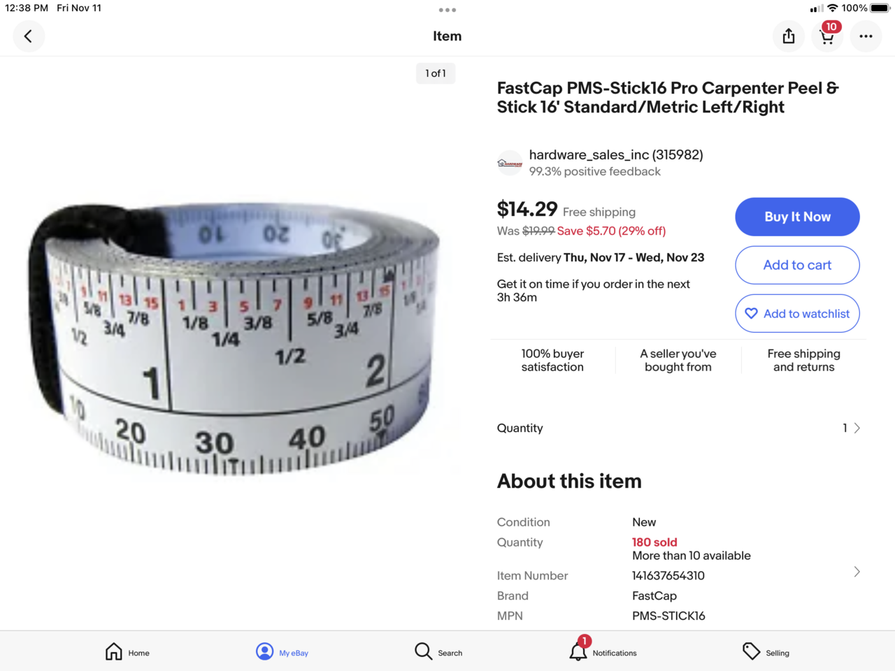

          Drilling the holes is no problem if you use tap magic for a cutting oil and a good drill bit. I think your purchase is the most economic option. I wasn’t too happy with the measuring tape on my SawStop, I wanted all the little numbers all the way down. I replaced it with
          capncarl commented
        • 3791
        There are a lot of tapes available, most of which I didn’t like either. I’m not into metric, I can use it but have been using imperial all my life and it is too late to change.
