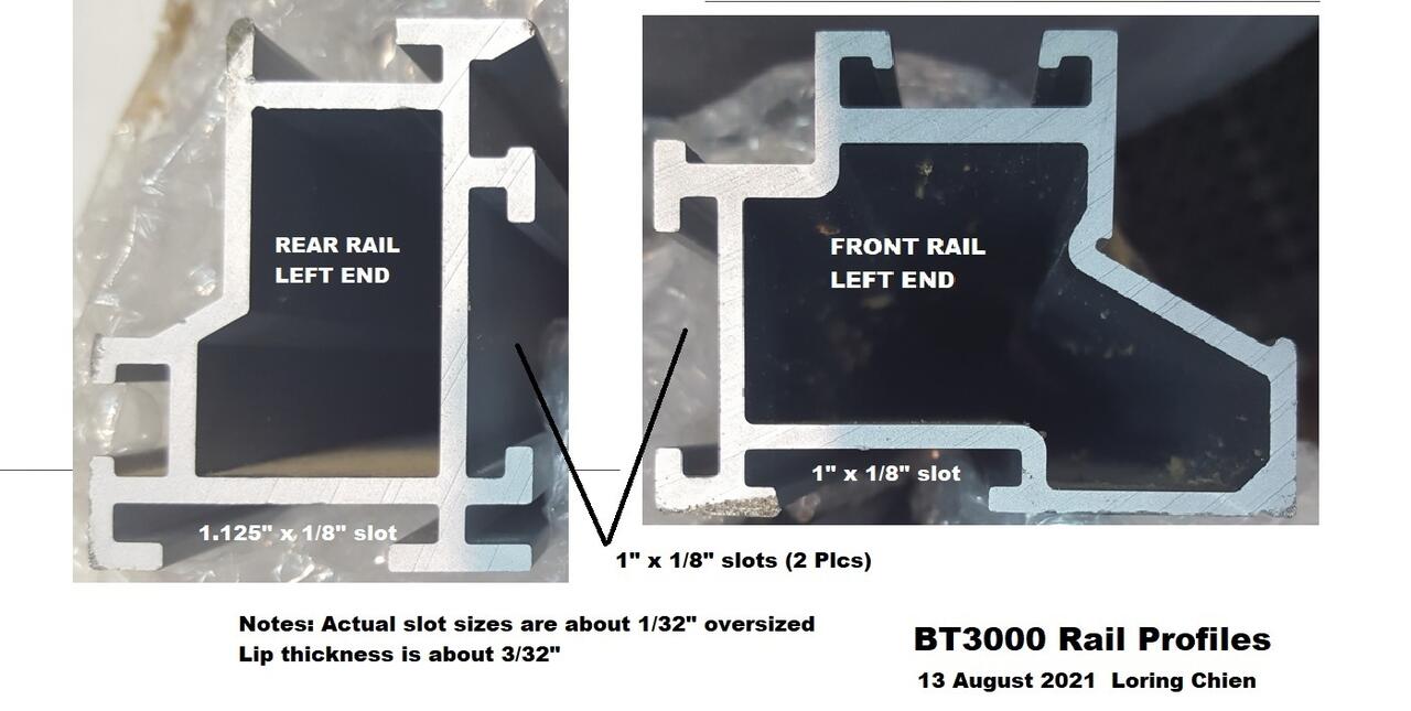

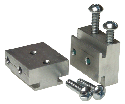

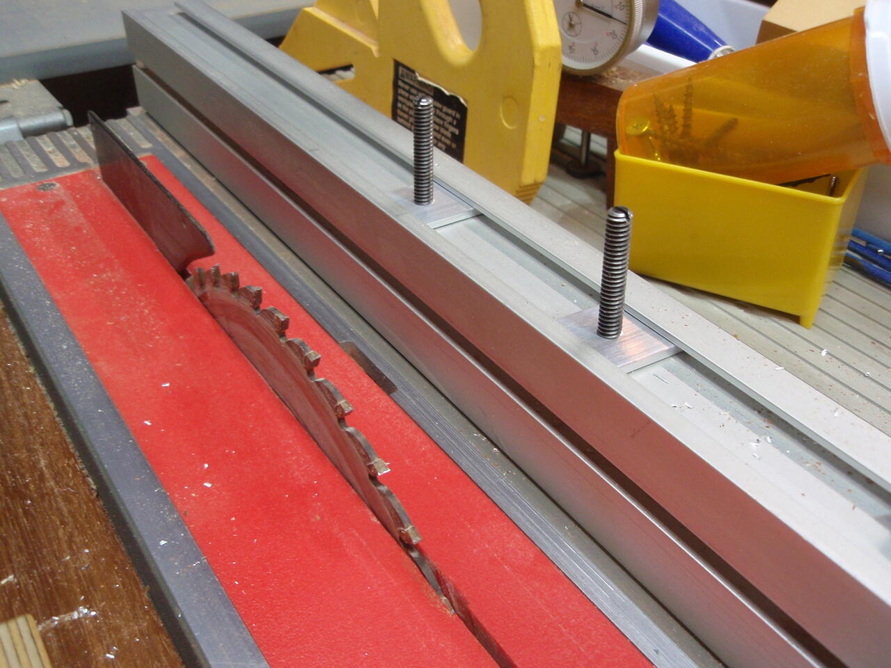

        After a bit more thinking, some universal T-bolts for the rip miter fence make more sense.
        The two big slots in the rip fence and the miter fence and the front and rear rails are sized to take 1.00 inches x 1/8th and 1-1/8" x 1/8th.
        So I took some 1/8th flat Aluminum 1.00 inches wide and cut 1-1/8" long rectangular plates, and drilled a 1/4-20 threaded hole in the center.
        Put a 1/4-20 x 1-1/2" stud (or in my case, a 1/4-20 x 1-1/2" set screw was an easier and cheaper buy) and I have these. Used a drop of super glue although Maybe just some red or blue loctite will work. Other threads such as 10-32 and 8-32 will work; 1/4-20 only has about 2 threads engagement in 1/8th inch but its OK and I have a lot of knobs and thumb nuts in 1/4-20.
        These nuts fit in the slots on the rip fence, miter fence and the inside and bottoms of the front and rear rails. (may have to rotate 90 degrees as some BT slots are 1" and some are 1-1/8", this will fit one or the other when rotated since the base is 1" x 1-1/8")
        Click image for larger version  Name:	P6051281.jpg Views:	0 Size:	129.3 KB ID:	855212
        • 22044

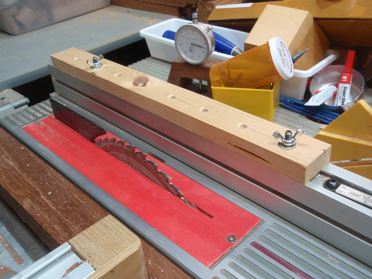

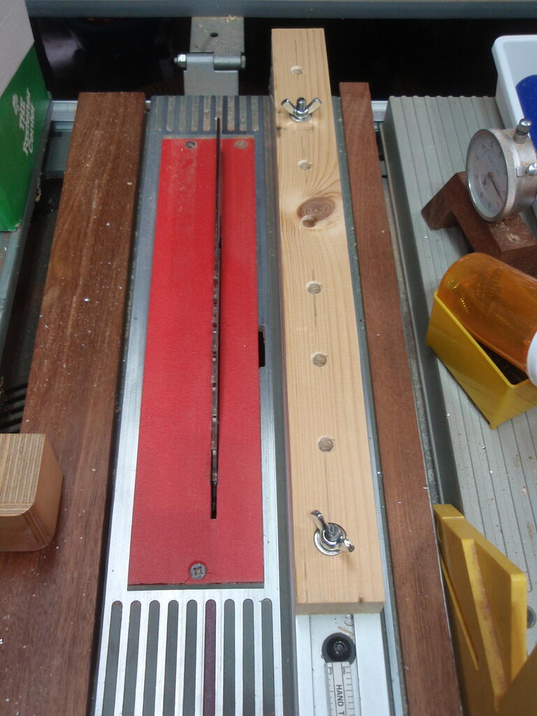

        DIY T-Bolts used to mount a rail to the top of the rip fence.
        So from here its easy to see how you can mount auxiliary fences, sacrificial fences, stop blocks and other rip fence jibs to the rip fence, either side.

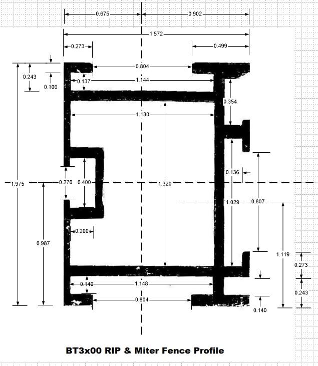

        The fence is 1.572" (1-9/16") wide and the 5/16th inch holes are located 0.675 (11/16") from the left edge.
        I used 1/4-20 wing nuts. Some 1" threaded knobs would work well. Tightening the nuts or knobs locks the T-nuts and rails to the rip fence.

          I already have solutions for tall rip fence and sacrificial and short rip fence (for repetitive short crosscut cut-offs without kickback) which use the Rockler fence clamps I have shown on several occasions.
          But basically, if you have a pair of these T-nuts and make the top bar like I did, you can fasten just about any accessory solidly to the rip fence (or the miter fence for that matter), screwed non-destructively into the top bar.

            The quarter inch threaded version might be a little shy in head diameter for the BT3 1" tracks; definitely too small for the 1-1/8" track.on the top of the rip fence and miter fence.
            The 5/16th inch threaded version might work for both and will require some grinding. At the minimum A dimension the amount hanging onto your track lips may be almost nonexistent.

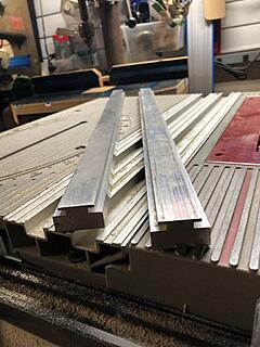

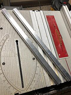

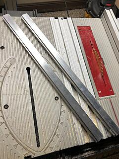

            I have 4x 2' sections (one of them is cut) of the original aluminum T-Block extrusions. With these extrusions you can make your own fixture blocks by cutting, drilling, and tapping.
            You can see my original post here - Aluminum extrusions for BT3X00 fixture blocks - The SawdustZone
            Hit me up if you are interested. I don't have my BT3 any longer so would be great to see these go to a good home.
