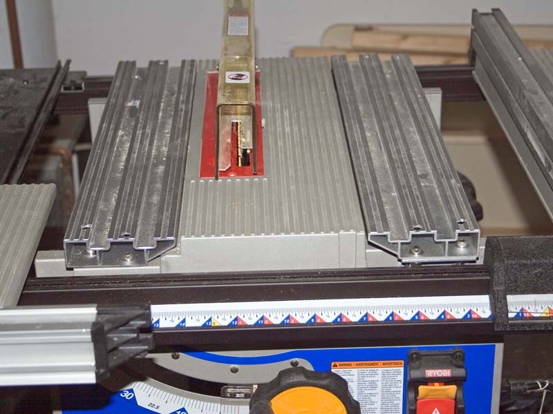

    Several people used 3/4 plywood and made their own. I'm about 500 miles from home at the moment to check, but I think there is enough space to double stack two pieces of 3/4 ply and make a groove in the top one for the T-Track. The aluminum T Slot mounts onto the base and the plywood one can do the same.

      Making you own like Hank Lee (leehljp) suggests may be more expeditious and cheaper and work just as well. It is not hard, using purchased aluminum miter tracks and you can even get the T-track miter that captures the miter bar or get the combination miter slot and parallel standard T-track for hold downs such as fingerboards and hold downs.

        Curious to how those wood frame are attached to the front and back rails ?? Maybe with some type of clamps so they can be easily moved ??
        Anyone have pictures showing the mounts ??

          In the top photo, in the open ends of the miter slot extruded aluminum, you can see the screws that hold it on - and they go through a hole in the top. That pict shows the attachment that is a little different than mine. Both work fine IMO. In the first pict,, it looks like the extruded aluminum is bolted onto a flange or
          "L" snapped bracket or flat piece of metal that is somehow (screws) attached to the frame of the saw. The saw frame can be seen on the front and back and is sticking out on both side, in the front and back. On MY saw, I bolted the extruded aluminum onto the Frame in the front, but it looks like the one in that pict is a little forward of what mine is. But it doesn't really matter, as long as it is firmly attached.
          As To the Wood Miter Slots. I think they are attached by using a screw on the front and back (after making sure it will be level with the saw top surface) and THEN screwing or gluing the miter slot onto the wood.

            The other thing to consider is that the way this saw is made, the blade and motor assembly is Not necessarily set square or aligned to the table top and ribs,
            So you are going to have to be able to align your miter slots after installation to the actual blade, for proper usage. This means you need to build some adjustment into the slots and then lock them in place once set.
            It is an idiosyncrasy of the saw.
            Also note that the miter slots are attached to the steel frame members of the main housing, not the sliding rails at the front and back. These should be left adjustable right and left and also clear for moving various attachments.
