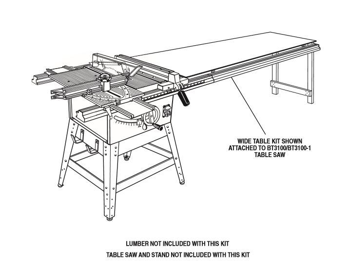

            can you cut a full sheet of plywood in half with these rails?
              • 22075
              The rails extend the track on which the rip fence runs. it extends them by about 42 extra inches.
              You will need the table top which will mount between the rails, and you will also need some legs.
              THere was a steel leg kit but it is also easily made from 2x2 or 2x4 pieces.
              When you have those then you can rip or crosscut (the terms are a little ambiguous with sheet stuff) large sheets of plywood - An outfeed table is suggested or a helper or two because of the awkardness of handling large sheets; then tend to want to get away from you if not supported.
