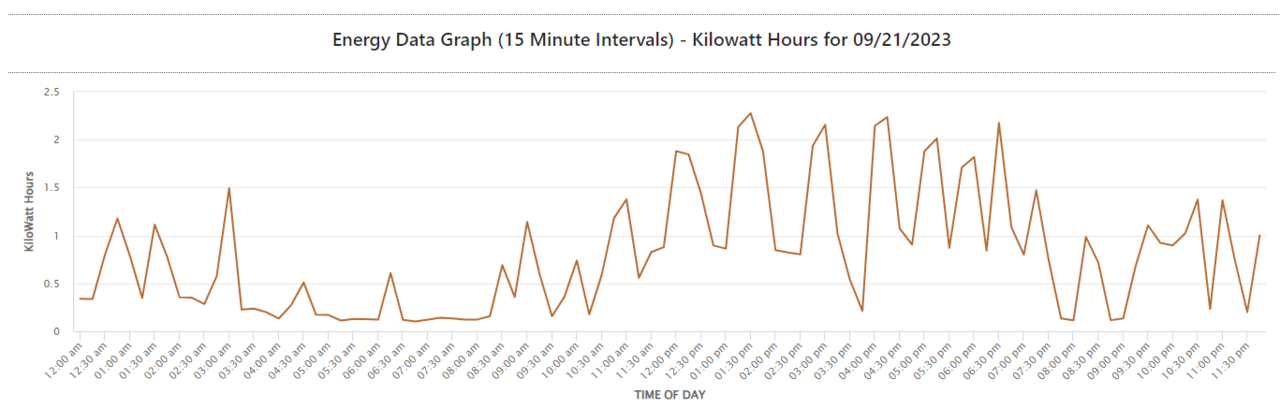

    Click image for larger version  Name:	image.png Views:	0 Size:	150.5 KB ID:	856269
    Here's yesterdays Smartmeter data showing electrical usage at my house in 15 minute slices. I.e. the kWh used in 15 minute intervals.
    You can clearly see at night when it was about 79F outside minimal usage and during the heat of Houston daytime around 100F the AC was cycling about every half hour.
    Interestingly my baseline looks to be about 100 Wh per 15 minutes which is an average of 400 watts which is Computers/monitors printers on standby, fridge, security lighting, wifi router and TV set top boxes, various remote controlled stuff, wifi smart switches and motion detectors, and handfuls of USB chargers​

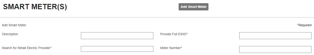

        • 9562
        How do you get that data from your smart meter?
          • 22085
          in Texas, you need to get your smartmeter ESIID from your electric company bill. and the meter number
          Go to this website and create an account
          https://www.smartmetertexas.com/home
          then click Smart Meters > add smart meter​
          to fill out this form
          Click image for larger version  Name:	image.png Views:	0 Size:	33.9 KB ID:	856328​
          Once you have it on your account you can just view the dashboard each time you log on there's lots of options including the fineness of the report (15 min min) and how many days you want including history and the option to download data for excel spreadsheet if you really want to go to town.
