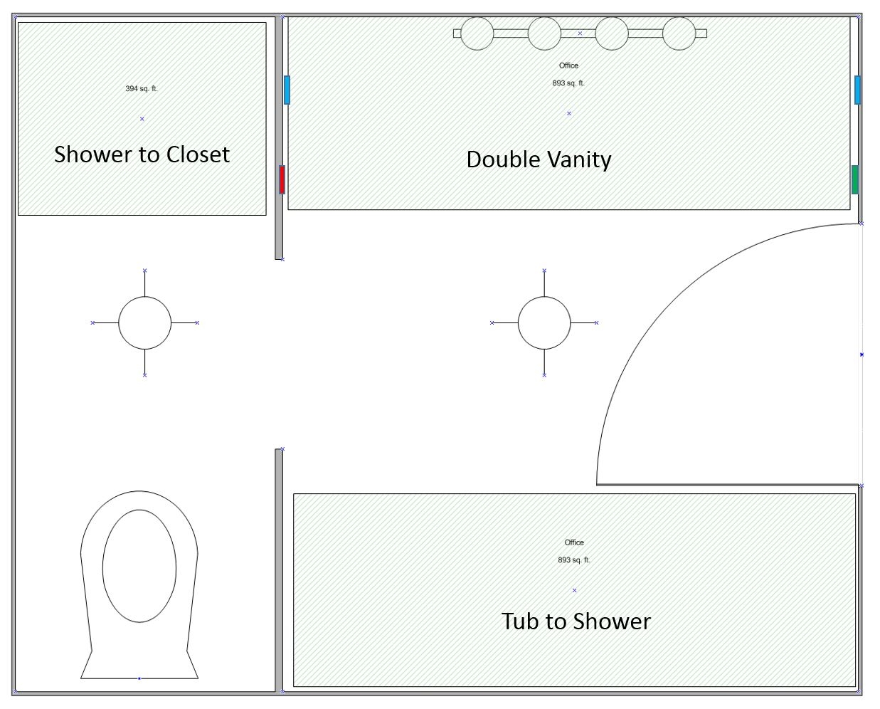

    Below is a rough sketch of our master bathroom. I need some help deciding where to move some electrical things.
    I removed the tub and installed a 3-piece shower kit. The walls over the shower are waiting to be sanded and then painted so we can start using that shower. Then I plan to demo the old shower which is across from the toilet. The floor to ceiling wall between the old shower and vanity will also be removed permanently and shelves will be installed for storage. The back of the old shower is actually recessed another foot beyond the back of the vanity.
    Removing that wall leaves me with an issue. Currently that wall has an outlet (blue box) and a double wall switch (red box). One of the switches control the light above the old shower and the toilet, and the other switch controls the exhaust fan above the toilet. I need to figure out where to relocate the outlet and switches.
    The double wall switch near the door (green box) controls the light between the vanity and the new shower, and the lights above the vanity.
    I am building a new vanity so I can relocate the one outlet to the side of the vanity cabinet. What to do about the fan switch and the light switch? I am thinking about changing the switch by the door to a 3-gang box and controlling both overhead lights with one switch, the other switch will still control the vanity lights, and the final new switch will be for the exhaust fan--which I may or may not move to a more central location in the bathroom.
    There's a walk-up attic above this, but there's plywood covering the ceiling joists over the vanity and new shower area so that will have to come up for me to work on it.
    Does my plan sound OK or should I look at other things?

    Your plan sounds good, but if posssible, I would make the fan switch a three way and add the second switch next to the toilet so you can turn it on during a reading session when you forget .

      3-way switch. No matter how many This Old Houses or diagrams of them I see, my head still wants to explode.
      The fan is a humidity sensing type so we always leave the switch on. If we need it to be on immediately, you toggle the switch twice and it turns on. However, it's a super quiet fan so you won't save any face by having the fan noise block out your bathroom activities.
      Now I'm wondering if I should keep the two overhead lights separate and relocate both of those switches next to the toilet. Really wishing I had done that while I had the new shower enclosure opened up to the studs... I think it will be the same effort either way and maybe even slightly easier.

          Forget my original idea. I was up in the attic and it's going to be a lot more straight forward to move the two switches next to the toilet rather than by the door. Shorter path and I won't have to move any attic flooring. The outlet is still going on the side of the new vanity, though.
