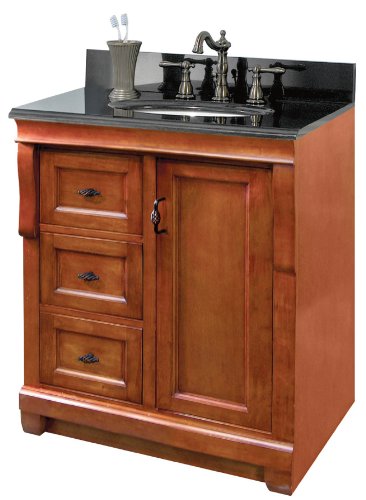

    This brings me to choosing the vanity/sink (among other stuff). The current vanity is 33" wide, which is not a regular size. I think a 30" should fit there. I want one that has a few drawers and some other storage options. But I want to be sure the plumbing does not come in the way of that. The plumbing looks like this (the 2nd picture). The distance of the output hole from the left wall is around 27.5 inches.

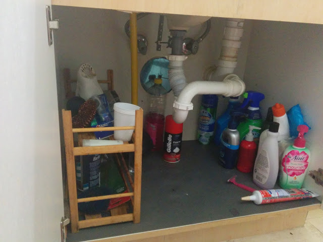

    Please ignore the patch-up job I did when I fixed a leaking pipe recently. I think it can be neater, without the flexi-pipe.
    That said, the current vanity does not have any drawers; will the pipes here pose a problem?
    I was thinking of picking something like this 30" variety of this vanity :

    You'd have to do some measurements to be sure but it looks like those drawers would hit the shutoffs. But possibly they do not go all the way back? I'd do some measurements at home and then on the vanity. The valves can be moved but it means opening up the wall. If it's plastic supply lines, they shouldn't be too tough to move but you might have to go to the other side of a stud which would require access from below (assuming that is how the supply comes in). If it is copper, it takes a bit more time but still may not be very difficult. For that vanity, the supply needs to be on the right side of where the vanity goes. Yours are not now, it's a question of how difficult it is to move them. If you have access to the lines below, it shouldn't be too bad. But it means a bit of drywall work which will lengthen the job.

      Thanks Jim - that's a lot of food for thought!
      I need to check the measurements of the drawers - maybe they only go half-deep.
      I am hoping not to disturb the plumbing too much - even if it means selecting a different vanity...

        That bathroom actually looks pretty nice, at least from the pic.
        What is the second pipe that goes up on the right for? A vent? Does it then go back inside the wall? Seems odd to me to have a drain go back up, and also odd to have a vent that starts inside the cabinet.
                Thanks, but after 15 years of life, the bathroom tiles have cracks, and the vanity's particle-board is showing. Any excuse to upgrade :-)!
                Yes, that pipe on the right goes into the wall for sink's "out", and it also has a tall vent. Came with the house, so I ain't sure of the logic behind it...
