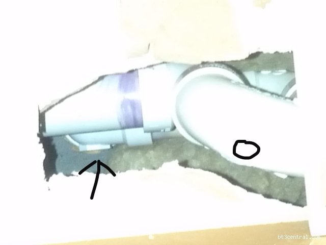

    I had to reduce the height of a kitchen soffit to install some new cabinets I built. I carefully removed the soffit with crown molding attached and cut it shorter with my circular saw. I attached new nailers to the back of the soffit board and began to screw them into the ceiling joists. All the previous nails were at 16" on center so I used those spots.
    Well, I needed to adjust the position of the longer piece so I unscrewed it when water starts to trickle down the screw. I bolted grabbed a bowl and bolted for the basement to shut the water off and then I turned on a faucet to drain the system. Then I ran to the garage for my drywall saw.
    The water was a little stinky but not sewage bad so I was pretty sure I didn't hit a supply pipe. When I opened up the ceiling (mind you, my other approach was to cut the soffit in place with my saw, but the approach I was taking was going to be so much neater), I saw that I had drilled into the P-trap of our master tub--which we hardly ever use. The joists were 16" on center except in this spot. I guess the finish carpenters nailed into drywall. The plumbing was also weird. It looked like 2 P-traps. I'll have to take a picture.
    Anyway, drove to HD and got some JB Weld for PVC. Worked like a charm. The day was downhill from there.

    So your tub is directly over the soffit? Whodathunkit...
      Maybe this is common practice, I don't know, but seems strange to me. Pipe indicated by the arrow is the tub drain. They ran it to the right, then down into the trap and then back to the left towards the exterior wall of the house. This would put it in line with the toilet. Why didn't they just go straight down into the trap? There is no joist in that area to prevent them.
      Anyway, the circled area is the patch. Sorry, this tablet takes horrible flash pictures.

        That's fine, but is there a vent for the tub? I don't see where the vent/ overflow would be coming from....
