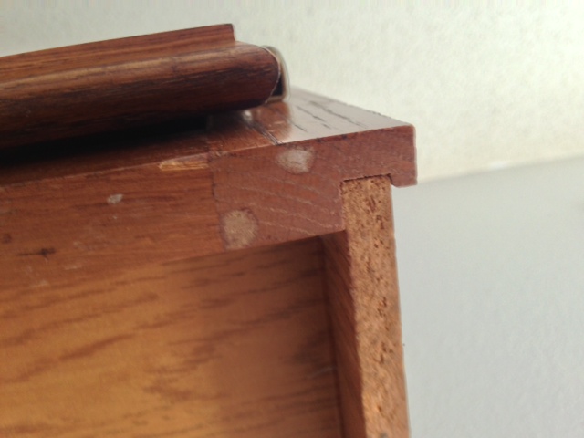

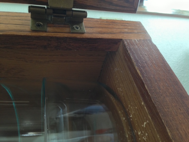

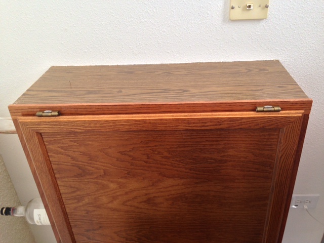

    At some point in the near future, I'm going to have to do something with my kitchen. The flooring needs to be replaced, the cabinets need something to happen, and I need a new counter top.
    The main thing I need to figure out is what to do with my kitchen cabinets. They are the normal 1988 contractor-grade (1/2" particle board)
    My choices are:
    1) Paint them (this is probably out. I'd normally go white, but I have several white appliances and that wouldn't work out well)
    2) Reface them
    3) Buy new cabinets (I'd like to avoid this, since I don't really want to spend that much money)
    4) Build all new cabinets (I'd really like to avoid this as well. I could probably handle this project, but I foresee it taking a very long time).
    My main questions are around #2. Most of the kits/instructions I see concentrate on replacing the doors and drawer fronts, and using veneer to cover the carcass parts. I'd be comfortable building the doors and drawers myself, but it's the veneer that has me concerned. Seems like it would be prone to scratching through. Does anyone have any thoughts on this? Also, is it possible to perhaps use 1/8" thick pieces of veneer instead of the paper thin ones? That would add some durability (while of course possibly causing some other problems).
    Or, maybe there's an option that I'm not seeing? I'd love to be able to take off the face frames as well and remake those, but I'm guessing that there is a 99.9% chance that the cabinets would fall apart if I tried to remove that.
    You could use thicker veneer, but once properly adhered, the standard veneer is no more likely to scratch than solid wood.
    The Taunton Press Refacing Cabinets book would likely answer most of your questions and provide some guidance. Many libraries have the book.
      A few questions and thoughts.
      Are the cabinets installed?
      They look like a dark stained Oak...what would you want to go to?
      What style do you prefer? Are overlay doors with euro hinges within your considerations?
      How are the drawer boxes made and what type of hardware (if any)?
        - Yep. Original with the house (1988)
        - I'm not totally sure yet. Throwing around a couple of ideas. Maybe a lighter Maple or a cherry.
        I've generally been thinking of the standard overlay. But I may consider full overlay doors.
        - Poorly They are about what you'd expect. 1/2" particle board with slides underneath. The drawer front is a separate piece screwed on. In other words, if you took the drawer front off, you'd still have a drawer with 4 sides.

          I am not an expert in this but I went through a similar exercise about a year ago - so here is my opinion.
          Kitchen cabinet has 3 main parts - carcass, face frame and doors/drawer fronts. If you are refacing - you are keeping the carcass and replacing face frames and fronts. Carcass is pretty straightforward to make, requires very little finishing work. It means making carcasses will probably be shorter than replacing face frames and fronts even though carcasses take the most space. 1/2" thick particle board is probably one of the worst material choices for carcass, better cabinets are made of plywood or at least thicker particle board. So in your case I would not leave in place particle board carcasses - they are not worth saving.
          European style frameless cabinets provide the most efficient use of space. They do, however, require better accuracy and precision to make than standard cabinets - face frames help cover mistakes and inaccuracies. Also frameless carcasses require edging on the front.
          Cabinets don't have to cost you an arm and a leg. In fact I doubt that making cabinets is cheaper than buying standard type cabinets. I replaced all cabinets in my kitchen about a year ago. My kitchen is about 200 square fit but oddly shaped, so I put in over 20 new cabinets. There was certain amount of non-standard solutions, for instance I have a counter in one place that is 13" deep and 60" wide, so I bought 3 upper cabinets and turned them into 12" deep base cabinets and made my own toe-kick. I found at Lowes clearance on a style of Ready-to-assemble cabinents, made a design and bought everything I needed (plus a couple extra cabinets for spare parts). Total price tag came to about $2K for all the cabinets. Cabinets have 1/2" plywood carcasses, oak face frames and raised panel doors - cove profile. Drawers are solid wood with dovetail joints. Cabinets are somewhat lighter in color than your current cabinets. Manufacturer says they used "wheat stain" - whatever that means. In order to add some trim I took a sample to Sherwin-Williams and made them match color - came out not ideal but close enough. Ready-to-assemble means that cabinets came in boxes and needed to be assembled with mechanical fasteners. Fasteners are not IKEA style - they are steel brackets attached to plywood panels in inconspicous places and interlocking with each other. I also figured out that making my own cabinets will take a lot of time and space to store those cabinets, that is why I bought cabinets at Lowes.

                      I'll first address what I think is your first choice. If the cabinets are intact and performing properly, refacing isn't that big of a deal. Since they are installed, the easiest method would be to use a paper backed veneer, and solvent based contact cement. Paper backed veneer once installed will hold up well. There's no expansion or contraction issues with it.
                      I wouldn't advise removing the face frames, because more than likely you will have damage to the cabinets. If you replace the doors and drawer fronts, very little face frame will show anyway.
                      First figure out the largest pieces of veneer you will need for finished ends, etc. You can buy many species of paper backed veneer in 4x8 sheets. It can be rolled up, and will fit in your car. To cover the face frames, just use a utility knife and cut strips to laminate like they will look like rails and stiles. Cutting the pieces to cover the old sections is best done with the remaining portions of the full sheets that won't be used. It takes just a little figuring. Allow a ¼" larger all around overhang to trim off after laminating. This trimming can be done with just a mill file...no need to rout in the house.
                      When complete, you can use a wipe on or brush on stain and or finish if you want.
