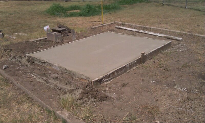

    Excavation and forms set. Back fill was done with recycled concrete. Compacted nicely and it was FREE!

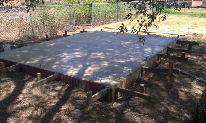

    Slab done. Not perfect, but not bad for 3 ametuers.

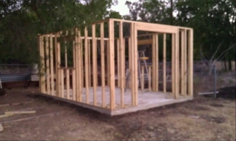

    Wall framing up. Modification to the plans were to add a second window and change the front wall for sliding doors instead of the garage door called for.

              6. The shop building is still waiting for money and time. Did figure out that we can pour the slab ourselves and do a decent job. Will probably hire out the excavation and then pour it in 2 24 x 13 sections.
                Go Don, you sir are hardcore, good for you! And separating the slab is a great idea, the larger the area the more likely you will be rushed to place and finish it but also it will get cracks.
                  Did you guys mix the concrete onsite? For your big slab you might just have several yards delivered and poured or pumped in. You'll get a more consistant mix and save a lot of time.
                    I had 5 yards delivered. When the truck pulled out thre might have been half a wheel barrow left in the drum. I ain't mixing anything over a yard.

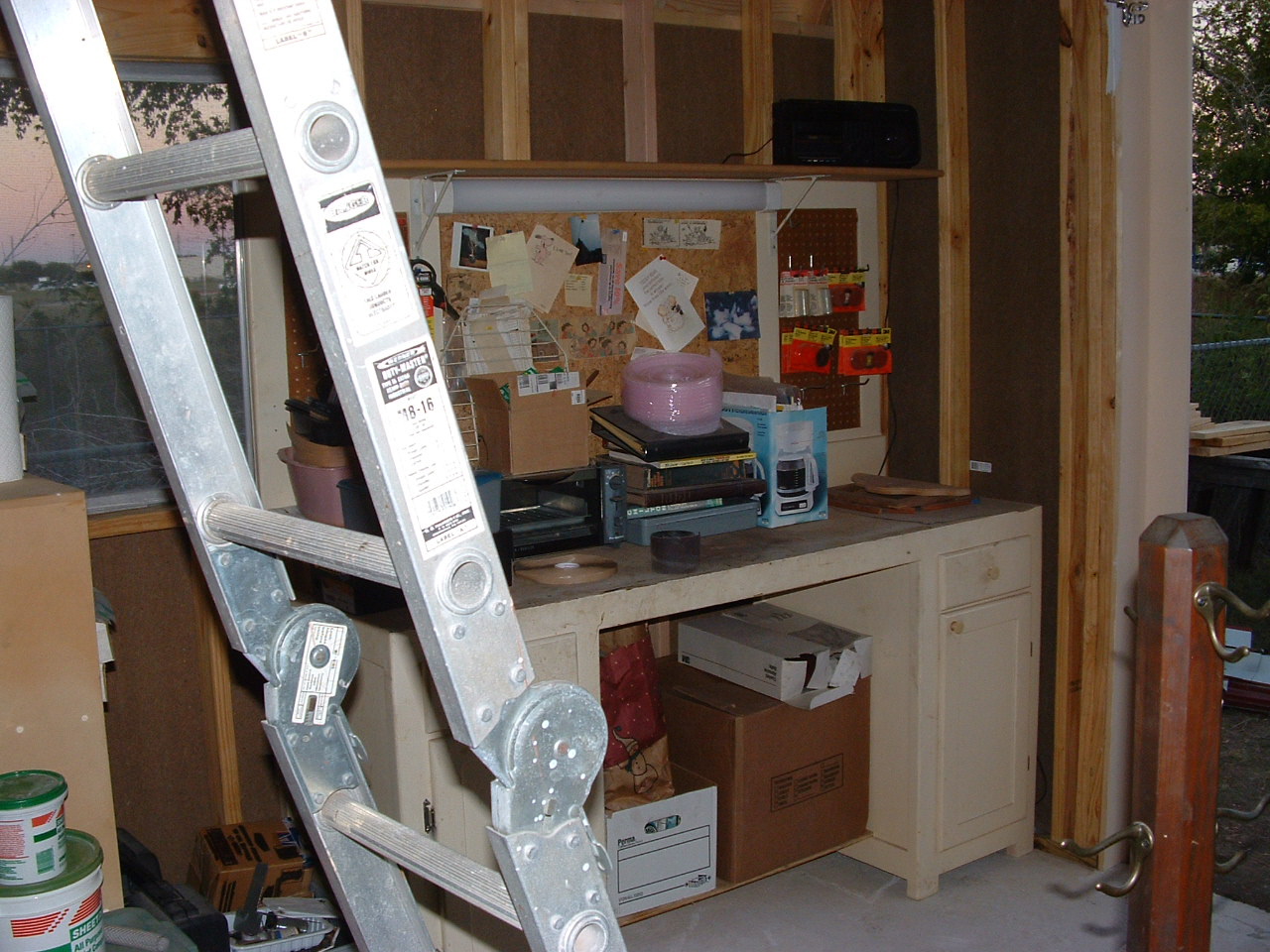

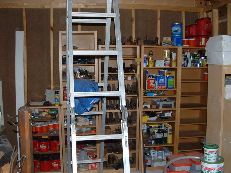

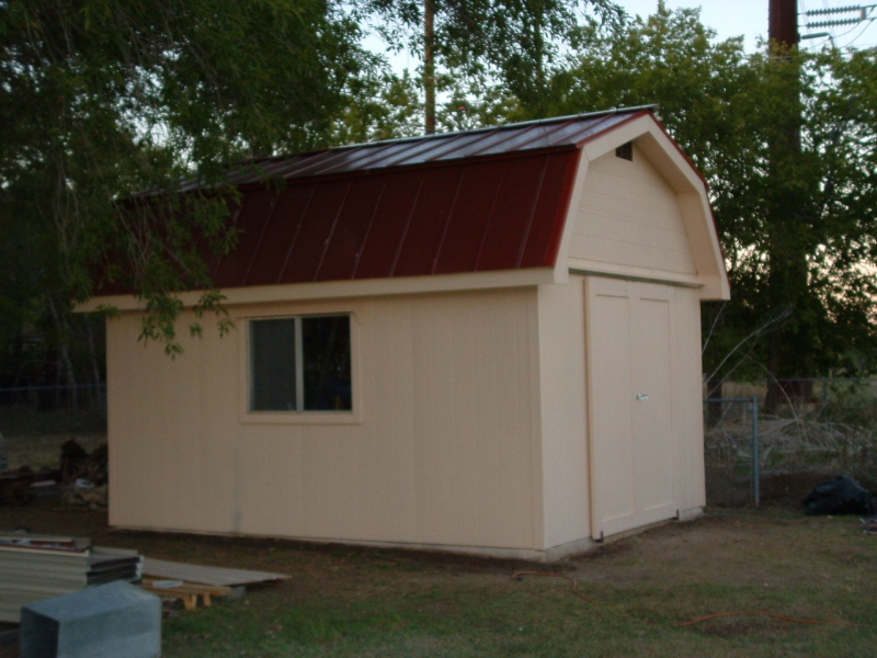

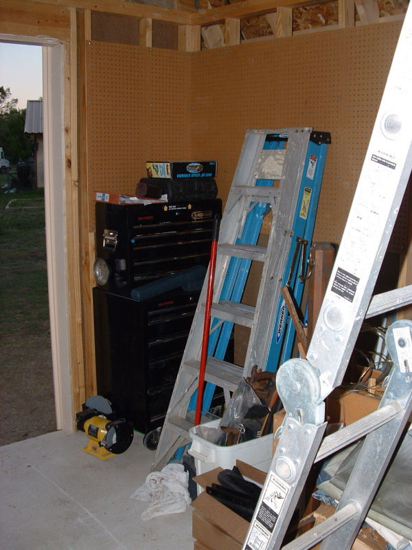

                      Finally finished!
                      I do have one trim board to add in front that will cover and protect the door track and rollers. I haven't put it up yet because I am thinking about painting the corner boards, door frames, and window trim a darker color to add some contrast.
                      We moved most everything in on Saturday and Sunday.

                      It is going to take a lot of time to get things cleaned out and organized.
                        That looks great. Nice work. Doing a darker trim sounds like it will add to the looks.

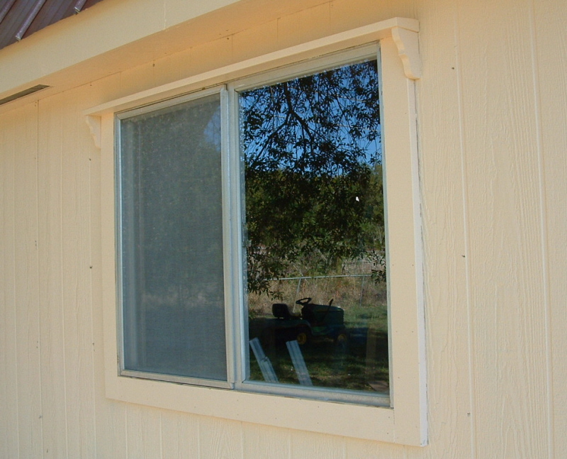

                              I was emailing the album link to my nephew this morning along with some info about the changes I made and it dawned on me that I missed a picture when I made the album.
                              The support board for the door track is beveled on top to keep rain water from standing and getting between the board and wall. My first attempt to bevel the face was done on the BT with less than stellar results. After setting up a quick jig, I cut the bevel on the new board with the planer.
                              I took 2 pieces of the first board, cleaned up the bevel and mounted them over the windows with a pair of corbels.
                              I have a feeling when SWMBO sees them up close I am going to be make about a dozen more of them.....
