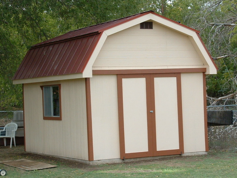

    Great job!!! What is the roof made of? I like the way you made shelves. and pegboard walls for storage.
    I built something like this a few years ago, but a little smaller. You've inspired me to finish off the interior a bit to provide additional storage. I use it to store gasoline powered machines, to keep them (and the gasoline) out of the garage.

        Thanks for the comments and compliments, gents.
        Originally posted by nickg
        What is the roof made of?I
        Nick, the roof is done with 16" Meridian steel panels. Quick and easy to install. One edge has a slotted lip to screw it to the sub roof. The next panel snaps down over the rib next to the slots, concealing the screws and making it water tight.

            That is a nice looking roof. I may have to do that when my current shingles need replacing. If you have to cut a panel at the end of the building, how do you deal with treating the edge?
              g.
              I bought a Frued Diablo ferrus metal blade that gave me a clean cut. Every panel was cross cut at least once with no clean up required on the cuts.
              I didn't use the rake trim that the instructions called for, opting to go with a simple drip edge sealed with tape instead. I did the same with the Playpen roof a couple of years ago and still haven't had any leak problems.

                    That's a good looking shed, but after seeing the interior pics I'm starting to think you built it just to house you plane collection.

                      Actually I moved them to the cabinet in the corner on the right, out of sight from the window that is away from the house. The move was more to free up the easier to get to cabinets for supplies and tools I may need to access than real worry about a break in. (The yard is patroled by a very friendly and unarmed Pit. Neither of those adjectives could be used to describe me!)
                      Finally got the trim painted and put up the cover piece over the door track/rollers. I compared about 10 -12 paint chips from Lowe's to the wall color and then remembered the left over gallon of brown in the paint locker.....
