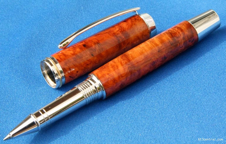

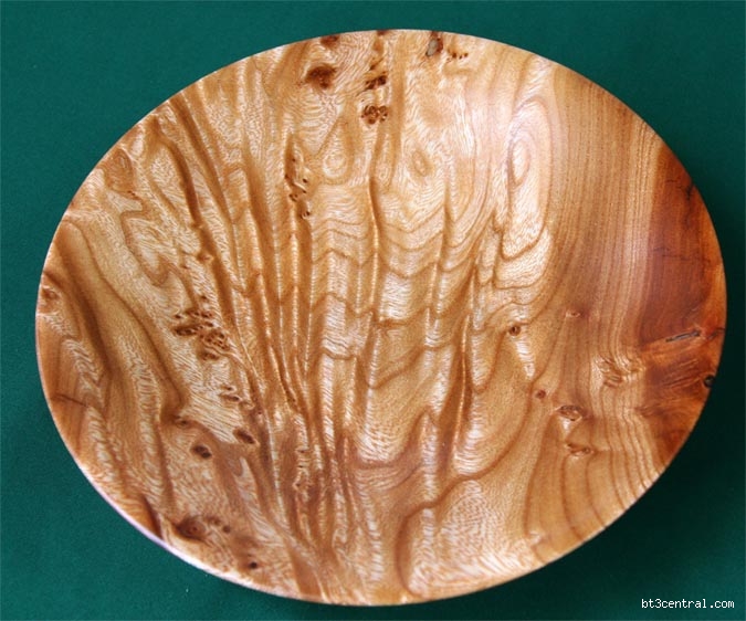

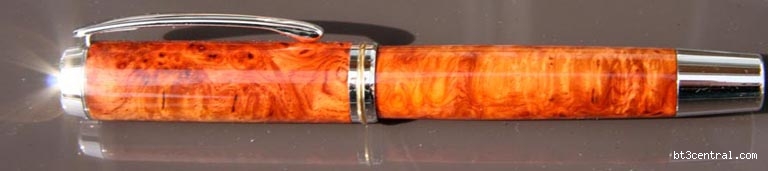

                      I have seen several posts on another forum in which engineers and maintenance folks at Bell helicopter (Ft Worth, TX) area use micromesh to sand scratches out of the plexiglass. Micromesh may conjure up sanding of sorts but some superfine microgrit sandpaper as in 12000 micromesh is finer than a lot of polish out there.
                      Micromeshed items are below - done over acrylic finish (cyanoacrylate) and or wood. No scratches and plenty of pure sheen/shine. Click on the individual pictures and look for scratches. None there. And no, it was not like that at the beginning. MM is what cleaned those up to that degree of shine. It will do the same for DVDs and CDs too.

                        ^^^^This is why I thought it might work for DVDs.^^^^ I guess I'll just have to try it & see if I can't buff out the scratches well enough to make the disk work.
                        BTW, that bowl is remarkable!
