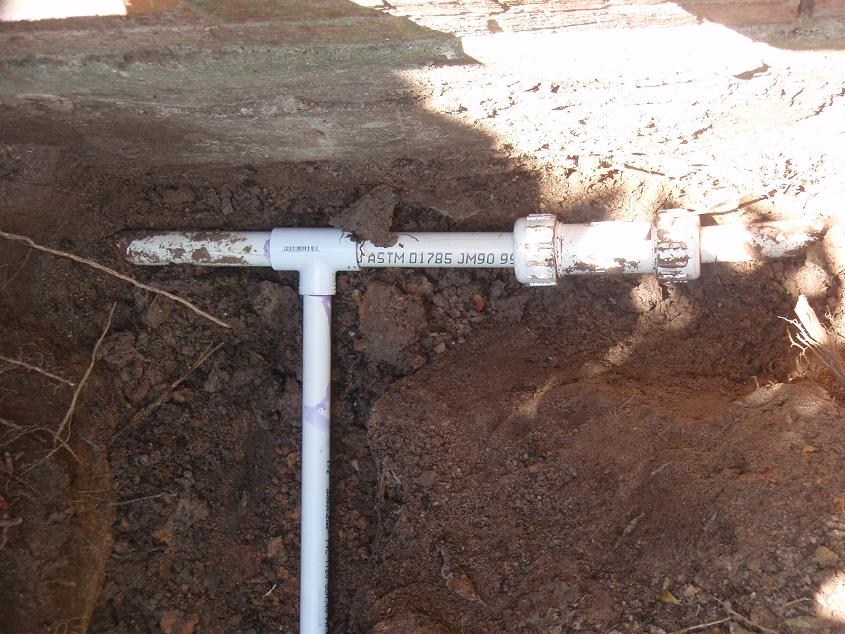

                      Here, Paul.
                      I knew there was a repair nearby recently when they did the foundation repair. I found it and observed a F-F coupling just about where the "T" is in the picture, and the Compression Coupling to the right.
                      I cut the pipe just to the left of the F-F coupling they used to fix it, and released the short piece of pipe and coupling from the left side of the compression device.

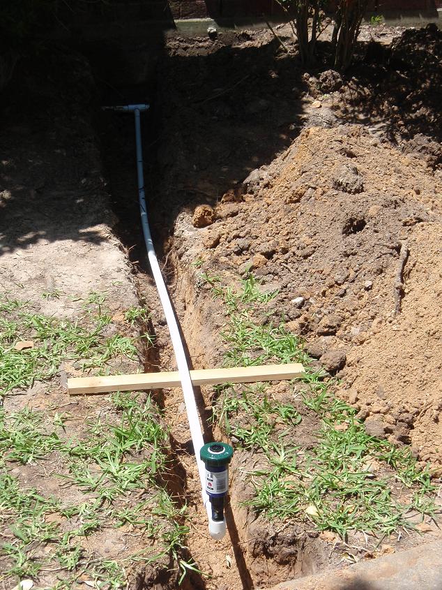

                      I glued a T fitting and short piece of pipe - which I slipped into the left side of the compression fitting w/o tightening the compression fitting. Then I glued the left side of the "T" to the cut end of the pipe; the loose end in the compression fitting allowed me to push and twist the glued fitting, then I tightened the compression fitting. It was all a lot harder than it needed to be because the foundation was only an inch from the pipe and it was scraping some concrete projections from the foundation, the shrubs behind me and the depth of the hole all made for a backbreaking experience. I slipped a short piece of pipe into the side port of the "T" so that it was easier to get it pointed in the right plane when gluing the "T" in place. Then I removed the short piece and glued a 10-foot section to the new sprinkler head... and a three inch piece after that bcause the sprinkler head was 10'3" from the "T".
