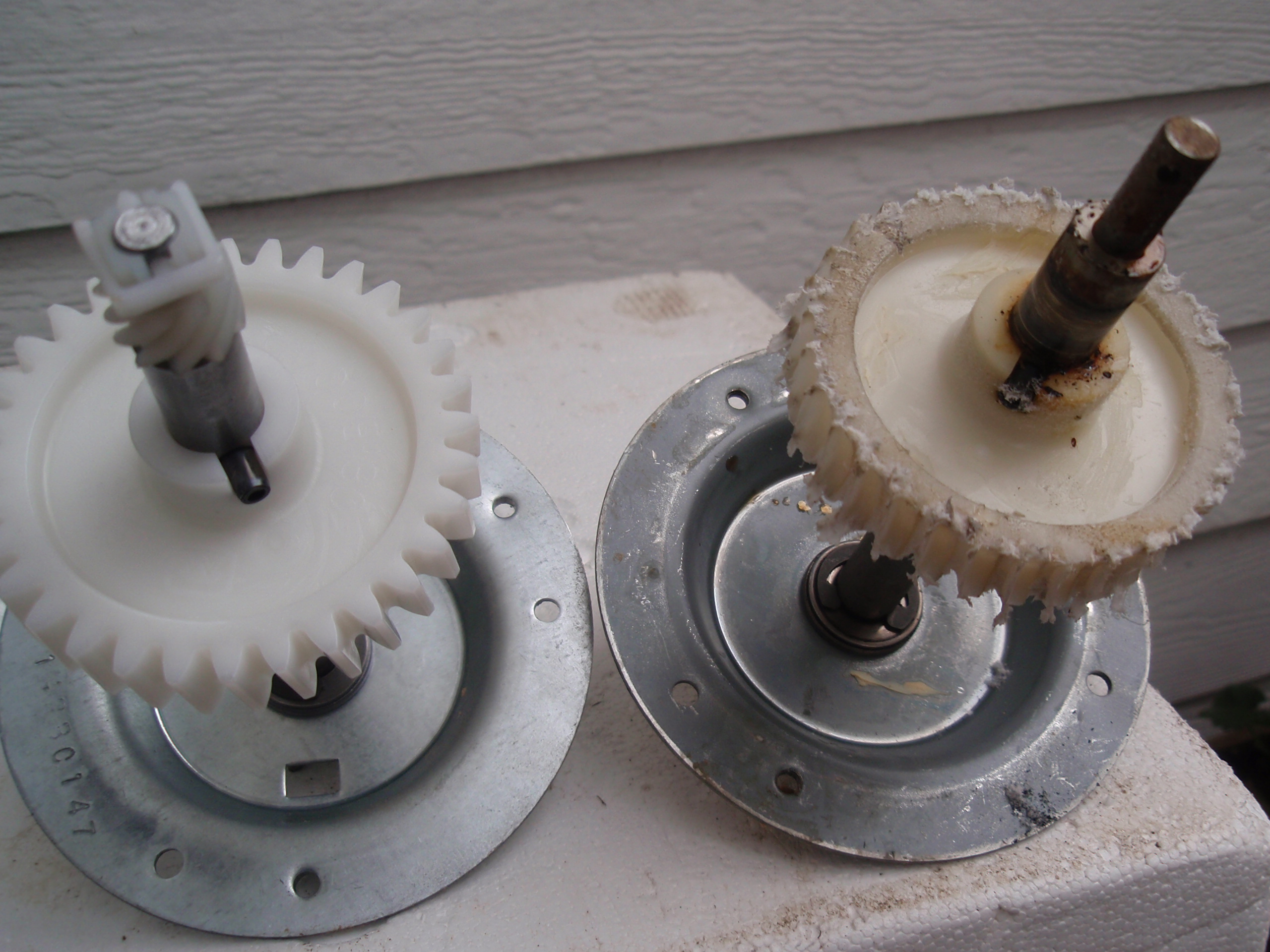

    The motor hummed but nothing moved. Had the opener installed for 17 years. Sears chain drive.
    Opened the housing and it was obvious, there was a pile of white dust in the lower cover and the drive gear driven by the worm gear off the motor was completely worn away... more dust and debris on the bracket.
    Why the **** did they use plastic (looks like nylon) gears? This thing probably would last 100 years with metal gears.
    Anyway, 35 bucks plus shipping for replacement gear shaft and sprocket assy, in the mail now. Just hope I can get at it to do the repair.

                        • 22060
                        Final results
                        Heres the new gear (left) and old gear (right). The worm drive gear on the motor shaft is a harder plastic and did not seem like it needed replacing.
                        Replaced it, neede some adjusting as it ran into and jammed on the trolley stop after the replacement. Had to figure out how to unjam it and readjust and now its all OK.
