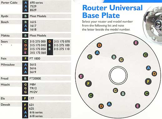

      Thanks for the info, especially the helpful FAQ. Offhand do you know if the Dewalt 618 router which gets generally good reviews would match up with the holes on the BT3000 router table? The Ryobi router mounting kit that I have might make it work.
      Thanks,
      Fred
        It appears the DW618 shares the same hole pattern as the very popular PC690 series and the Bosch 1617 series routers.
        Here is a couple of documents I've saved
        Jessem Router plate manual with hole patterns for many popular routers I down loaded in 2016. Starts on page 4.
        Router plate hole patterns
