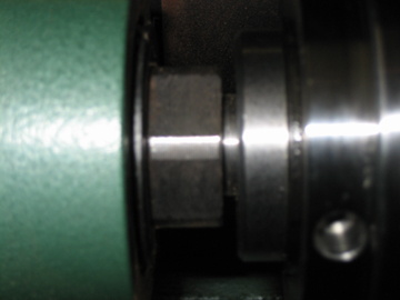

    I just took advantage of the Woodcraft sale, coupon, and free shipping to buy a Nova Midi Chuck (and some bushings to make up the $75 for the coupon) but now I'm trying to install it on my HF 34706. The chuck directions say:
    "This is important for accuracy. The chuck body must contact an accurate register on lathe, either a shoulder on spindle or bearing face etc (sic) to ensure chuck will run true. Any modification required (e.g. spacer) would be the responsibility of the customer."
    As you can see in the photo, the chuck lacks about the thickness of a nickel touching the nut on the headstock side of the spindle before it bottoms out with the jaws closed. Should I use large washers as spacers to make up this space? Is there any reason a washer would not work properly? Any other suggestions would be appreciated. Thanks.

      There is no adaptor. The chuck body is threaded and installs directly on the spindle. (1" - 8 TPI) If I open the jaws up all the way so that they do not block the threaded hole of the chuck body (on the tailstock side of the chuck body), then the chuck will install all the way on, but the jaws can't close. This defeats the purpose of having the chuck if you cannot adjust the size of the jaws.

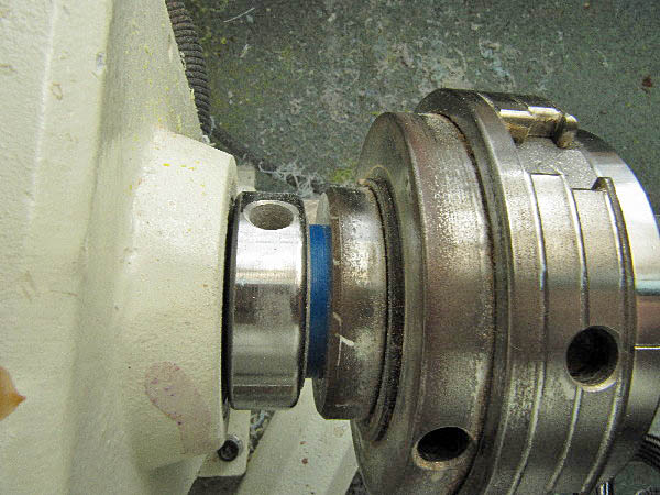

        Richard, here is a pic of that chuck mounted on my Jet with the jaws closed. You have room for 1.055" of shaft inside the chuck, measure the threaded area sticking out of your headstock, my Jet happens to be .99".
        A UHMW washer from www.pensbyhans.com/Bushings.html may be the answer it will also keep the chuck from locking up and being difficult to remove. Pic with the washer installed is attached.

          Thanks, Dick. Your photos and descriptions helped greatly. Think I'll try the washer route. Also, think I may try this guy's pen bushings. They look interesting.

              Sorry I am so late returning to the party. My #34706 threads measure out at something like 1.05" from the flange surface. If you do not have enough depth in the chuck to handle that, and it doesn't look like you do... I would get a spacer like Dick mentioned above. I had to do something similar with a grinder wheel which spins a LOT faster than the lathe, and it is dead on accurate... If the UHMW won't work for you, try McMaster Carr for a stainless machine bushing with a 1" ID. You may have to put a thin film of oil on the shaft to get it to go though...

                Thanks DB. I got a bushing as Dick suggested and it filled the space adequately. If it should break in the future, I might try the stainless bushing. Again, thanks.
