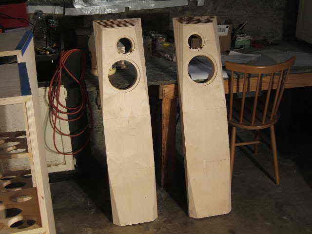

          So on the topic of saw blades...
          I just got a new circular saw (Makita 5008MGA) and used it for the first time this weekend. I’m in the middle of building some speaker cabinets. This was trying my first attempt at cutting facets. It’s just in scrap ply, 3 layers, glued together, as a test for when I get to the final cabinets. The saw cut through all 3 layers at 45 degrees quite easily. Almost like butter. The new blade has to be part of it.
          Let's see if I can include a photo...

            #35
            Jon- that is slick. What system is that? I have yet to complete my Audax speaker set, but I've recently been getting the hankering to do another.
            Speakers are, after all, what got me into WWing in the first place!

              #36
              Very sharp looking cabinet Jon. Reminds of the Avalon's we used at a CES show many moons ago. What drivers are you using, and what crossover configuration?

                  Thanks Dustmight. So are you "in the biz" if you were showing things at CES?
                  This is my first speaker design. And I wanted to make as high end of a design as possible. It's a 2 way. Other than that, I'm going all out. The drivers are both Scanspeak: A 6600 tweeter and an 18W/8531 woofer. The crossover design is still in a little flux, but currently it's 3rd order on both drivers.
                  Yeah, they're turning out to look much like the Avalons. Not that I necessarily wanted to mimic Avalon or anything. I built a lot of test boxes and took lots of measurements. The measurements in various configurations are mostly in pages 10 and 11 of this thread:
                  http://www.htguide.com/forum/showthr...1&page=1&pp=35
                  The facets really smoothed out the frequency response. As well the 8 degree slant of the front baffle helped a lot, too. So that's how I'm building the final cabinets. A bit of a woodworking challenge for a new guy like me.
                  When the cabinets are done I'll remeasure things, tweak the crossover a bit, and then tweak a little from lots of listening. Even in the flimsy test boxes they're turning out to be one of the best speakers I've ever heard. So far so good. Quite a long project but I'm having lots of fun.

                            #43
                            I think I have found the limits of the Ryobi BT3100. I’ve now got the facets cut in the 2 front baffles. They came out OK. Could be a little better, but not bad and I’m generally happy with them. The baffles are 3 layers of 3/4” Russian Baltic birch ply. It was a little difficult to do some of the cutting. I used a circular saw to cut the 4 side/corner facets. That went OK. Then I used the table saw to cut the top facet. The saw had trouble making the cut. I’ve noticed that the saw doesn’t slice through the Baltic birch as readily as scrap BC ply- the birch ply is notably denser. Here I had the saw cut through 3 layers of the Baltic birch, with glue, and at a 45 degree angle. It was slow going, the motor was slowing down a lot no matter how slowly I fed it, and it burned a bit. So that’s really about the limit.
                            Maybe such cuts will be easier with the new blade.
