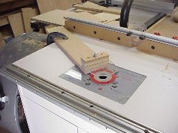

            • LarryG
              • 6693
              • Off The Back
              • Powermatic PM2000, BT3100-1
              Use a bit guard.
              Bit guards similar to these provide a large measure of safety, if your router table will accomodate them. Most insert plates and lifts have threaded holes for guide pins; the type of guard shown on the left mounts using these same holes. This particular one probably only fits the Veritas table but others are available to fit other brands. Or you can make your own from a small piece of polycarbonate and a couple 1/4-20 bolts.
              Another type of guard uses a long arm that clamps to the table top, out near the edge:
              I have a somewhat similar guard (no pic available, sorry) that doubles as a dust collection port. Also, Hylton and Matlack have some good ideas on this subject in "Woodworking With The Router." There are lots of ways to do it; any of them are worth doing.
